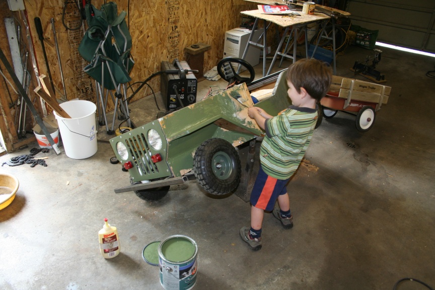

Hi, project goes very well. It all runs and i want to make it run better.
i want to improve part throtle response.
I bought the TTO 14mm meter.
I have a stock AF18E with #75 jet (factory), but longer exhaust pipe and open foam filter.
What temp should i look for that i would assume "normal" ?
I have some bigger jets (78, 80, 82, 85, 90)
The thing revs quite a lot imho and pulls very good.
Attached picture, my son paiting himself his new toy. He his MAD about this toy (which is not realy a toy for him but for me...lol...)
Thanks.
