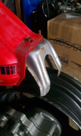

This is the front shield , had to make some cut outs for the fork tree
Head set front view
Headset back , leg shield cut for the fork tree. Going to get a glove box cover for it.
