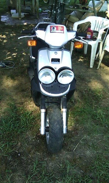

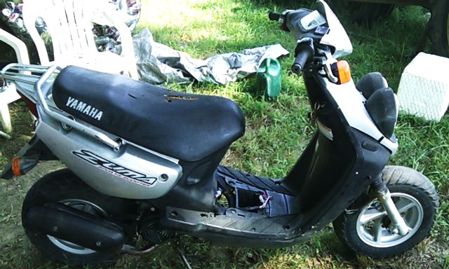

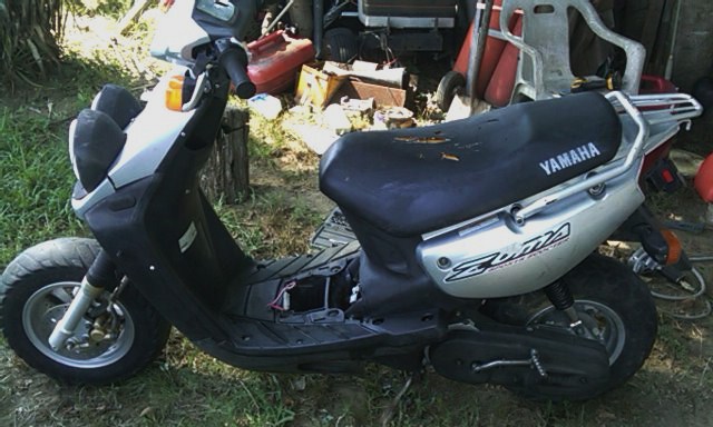

Well I decided I would post some pics of the 03 Zuma I picked up at the salvage yard on Tuesday. Spent hte past 3 days cleaning gunk off the motor and disassembling/cleaning dust,dirt, and gunk off all the rear components (gas tank, oil tank, etc etc) Got carb cleaned, checked reeds, new plug, fresh gas and oil, cleaned carbon from exhaust port and header, took flywheel off and took the oil pump out to clean and verify function. I have done 3 FULL days of work on this thing. The entire CVT was corroded and rusted tightm worst I have ever seen must have been flooded or under water or something. Despite all this poor maintanence and rough handling as soon as the carb bowl filled from the tank, kick kick kick VROOOMM she cranked without any trouble at all with tons of smoke out the tail pipe
Here are a few pics after i got the plastics and stuff back on, needs more work but at least she runs. BTW anyone know how to get a disk brake plunger unstuck??

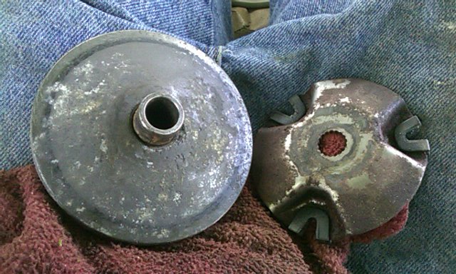

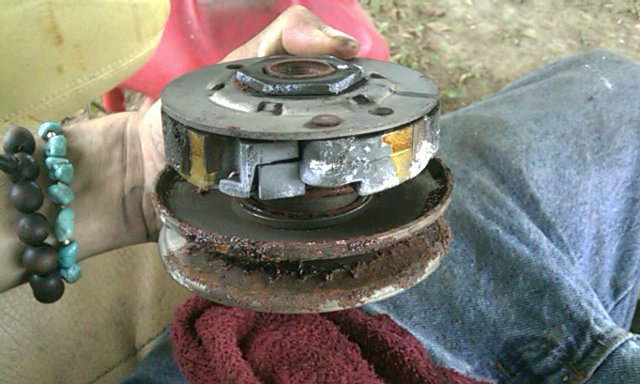

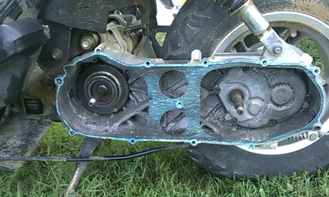

Here is a few pics of the CVT parts before I cleaned them. The pic of the crankcase has the large starter gear that I was unable to free up and remove after days of prying and penetrating oil so I just put it back together I can do without the electric start for now especially since the starter clutch itself needs replaced
