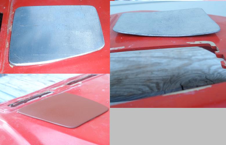

Sorry - can't find an OEM photo. Here's a cover I made. Cut to match the body line on the fender side. Rest is just outside the opening profile with rounded corners. Add a slight curve to hug the plastic.

without seeing OEM part,I made a notched piece that fits flush in the opening.I'll cut a cover piece like yours and epoxy it to the notched part. Hopefully I will wind up with a functional cap, which will be removable.Do you think this is the way the original was?How did you get the nice curve on your carb cover??

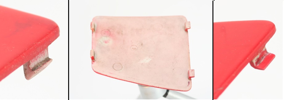

Your method is above what I did. The original part has flat tabs at the rear, and a ramped tab at the front with some spring to let it latch.
I've had a few NN50's. They get oil/grit under the cover and grind off the paint - like the mockup fender in the pics. I pull the fender to get at the carb, and was planning on a fixed cover to avoid the oil/grit issue. It's 0.040 aluminum and the OEM cover rests on top much like this part. Curve is a few hammer blows 'till it fits. Cutting the part took longer, painting the part took longer. Fab your part and post pics, I'm confident you will create a good cover.

Posted: Wed Aug 01, 2012 11:17 pm
IDK - flat tabs are fine. OEM part has ramped tabs up front. Sorry about the blurry pic...
So are you SLA printing the part?
Edit - Add a better pic of the cover tabs

Thank you mousewheels...i had never seen a real one either till now. Heres my finished carb cover... all cut from a pail i found blowing down the street one day. I picked it up cos it was gyro blue in color...lol. The engine cover i got used and still needs painting.
