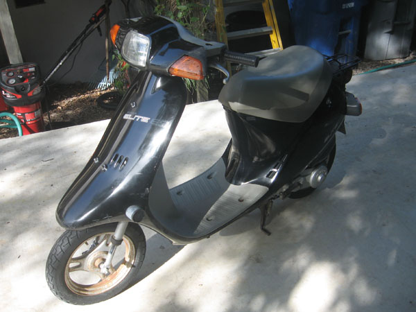

Anyway here's a pic of my latest acquisition. 1-owner, 1600 original miles :D
