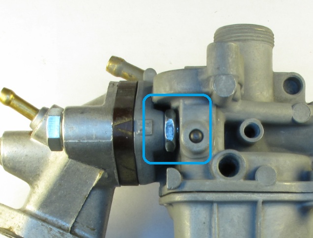

They have the bystarter positioned such that leaving off the plastic insulator between the carb/intake will allow a mounting bolt to distort the roundiness :D the brass air valve slides within. That binds it up causing an issue.
Used carbs sometimes have this issue too.
Will add a photo tonight...
Re: bystarter problem
Posted: Sat Aug 04, 2012 12:09 am
Here is a pic showing how bolt length on the bystarter side is critical. Assembly without the plastic insulator or accidental swapped carb bolts has killed more than one carb.
This photo is also posted in a related thread today. The nut is a fix for stripped thread. For your thread, there is just a hint of the bolt showing past the nut. The bolt must never contact the carb body to the right.
