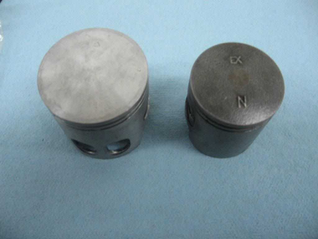

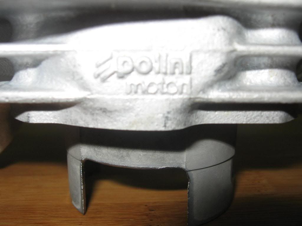

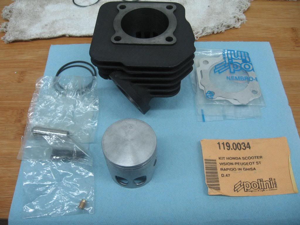

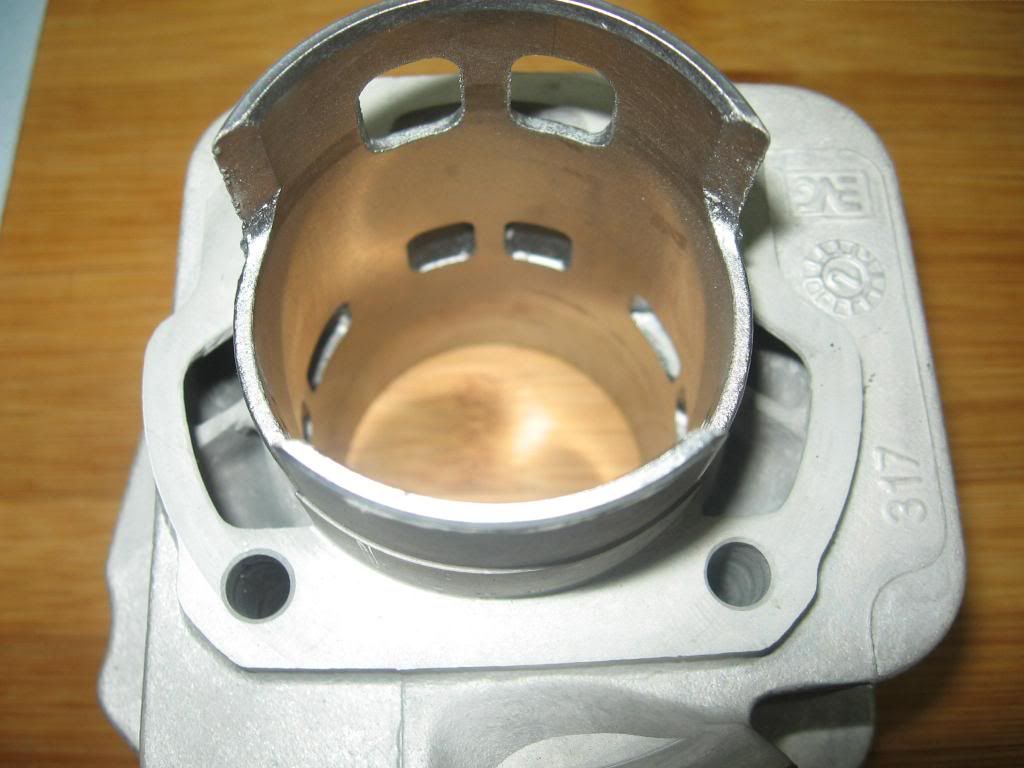

Ok, I finally took my camera out of his case. Here are some pics of the machine I bought brand new, 25 years ago...
I am now in the process of giving a second life to the engine... with one of these :
Polini cast iron cylinder kit
Comparison between Polini and original piston

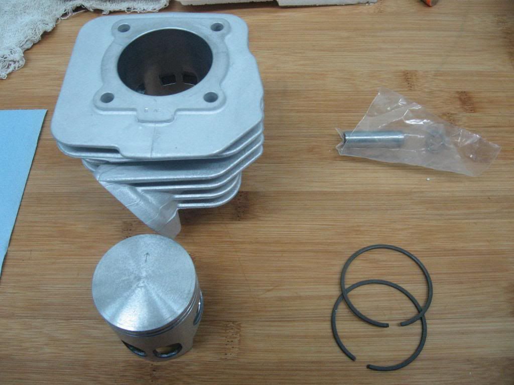

And le plat de r├®sistance : An aluminium Polini cylinder (46mm diam)
Made by Polini!
Chromed cylinder

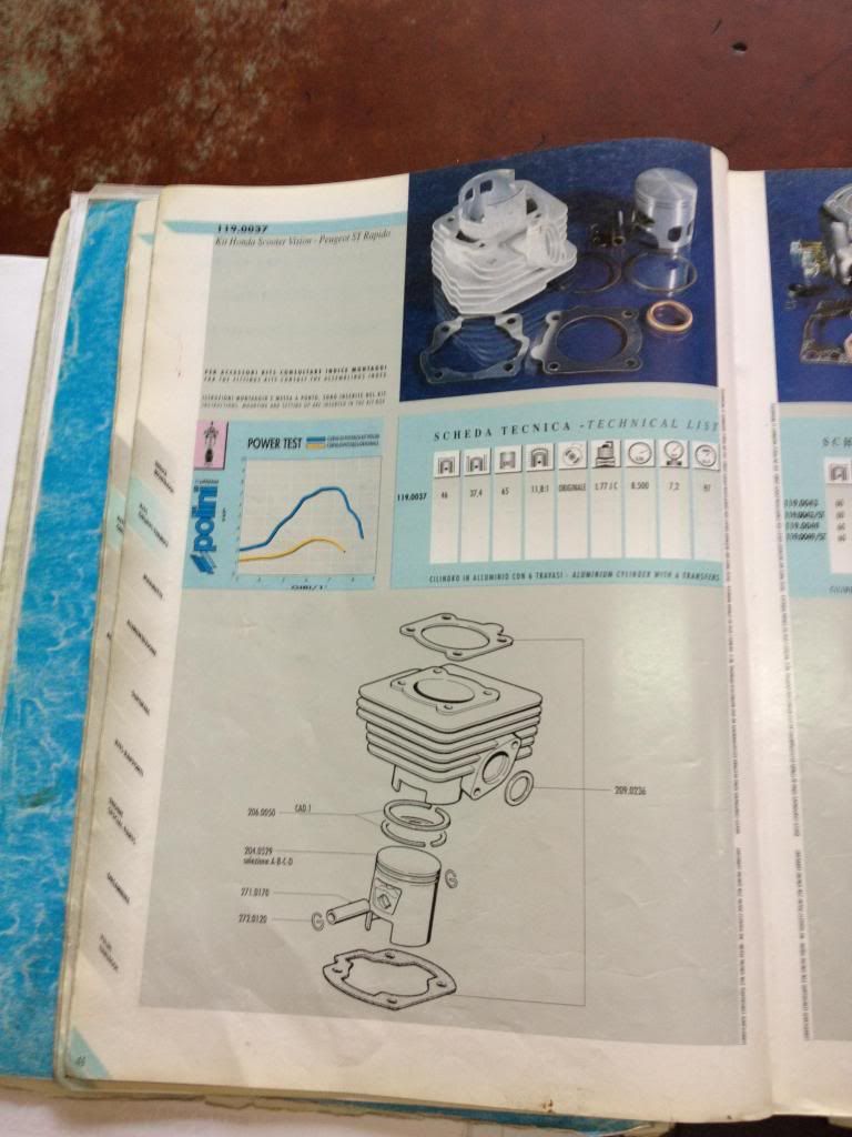

Datasheet of 119.0037 kit (sorry for the bad quality, this was supplied by the eBay seller)
Does somebody have this same kind of catalog page foe the cast iron? I would like to know the specs of the kit, and compare both...
