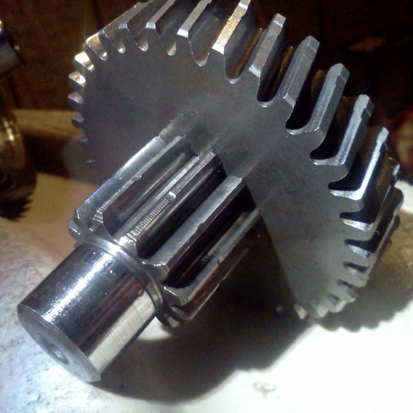

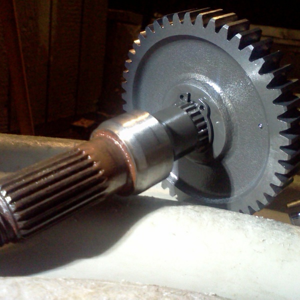

Ok picked up some Ruima 6.8:1 gears and after taking my gears off, they wont fit. I think I have the af05 gears still in my af16?

maddog
Posts: 2171
Re: '85 Aero Just Got Wings!
Post by maddog »
They no longer make gears for the nb50 and if run out of gas with the polini bore and seize just get .050 hone.
