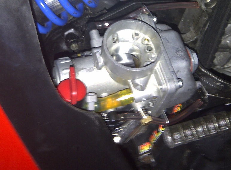

Here's the VM installed:
Started with my biggest pilot, a 35, and a 160 Main. It started & ran, just not too well. Almost rideable with fat needle at full rich.
Put in 40/155, idled well but ran worse. Hard to "jump the gap" off idle. Lost RPM unless I opened the throttle gradually and tickled it. Moving the needle didn't seem to do much. Temps stayed way cool I'm thinkin it's rich all over. Ran out of time.

Wheelman's pic rescaled to 50% then cropped...

Fixed that wacky pic. Snug fit.
