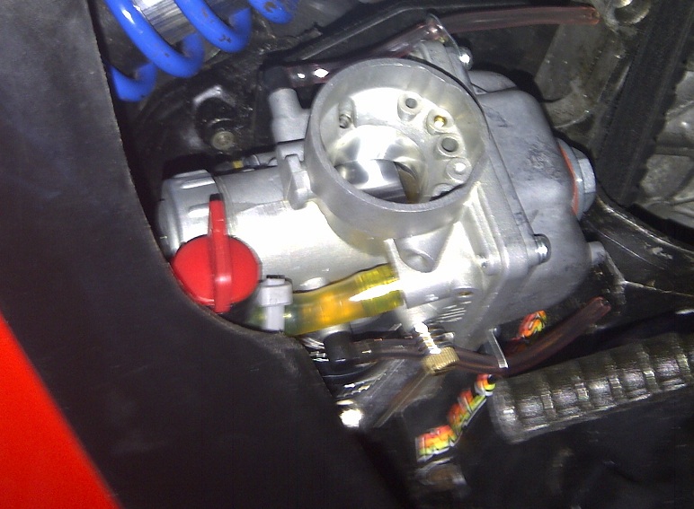

Here's the VM installed:
Started with my biggest pilot, a 35, and a 160 Main. It started & ran, just not too well. Almost rideable with fat needle at full rich.
Put in 40/155, idled well but ran worse. Hard to "jump the gap" off idle. Lost RPM unless I opened the throttle gradually and tickled it. Moving the needle didn't seem to do much. Temps stayed way cool I'm thinkin it's rich all over. Ran out of time.

Wheelman-111 wrote:Seems to me the Mik takes bigger, not smaller numbered Mains.
That's because you have a 26" Mikuni - it won't fit my monitor :)
I remember Mikuni jets had two calibrations like RedEft posted, wonder if that's what's up?
Wheelman's pic rescaled to 50% then cropped...

I'll be sorting out the Pilot Sunday and Monday. Evidently worse going from 35 to 40 - needing at least 2 turns out on the air screw to idle - so I put the 32.5 in and see if it takes throttle without nearly stalling - BWAAaaaaaaa.
Where's The Bear when we need him?
Fixed that wacky pic. Snug fit.
