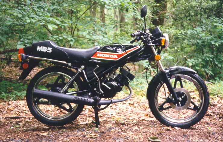

I've owned my clean black Honda MB5 since 1996 or so...
I fully rebuilt the motor last winter, as finally one of the main seals blew which is really the first major old part failure I've had on it.
At the same time I pulled the oil injection pump, put on a CNC made block off plate and started running Castor 927 premix. I may put the pump
back on (if I can rebuild it with new seals) but I was getting doubtful to trust it though it is rare for them to fail on these. I swapped the battery for a totally sealed gel cell,
the last one I had lated 4-5 years which is WAY better than what you get with the stock lead acid ones. Don't run an MB5 with a bad or removed battery as the increased voltages
will blow the bulbs, and the headlight bulbs on these are discontinued... I also rebuilt the front brake master/slave cylinders and put in new pads.
I'm running "Dream 50" Bridgestone Battlax race tires (these bikes run 18" tires), 1 tooth larger than stock counter shaft sprocket, low bars/weighted bar ends/nice grips, and a small tank bag.
Top speed is in the upper 50s in 5th (will do 50 in 4th) with a little hill and/or wind support! One popular mod is to swap the gear set and shift drum assembly from an 1980-1982 CR80,
giving you then a 6 speed transmission. Both MB5s and NS50Fs have an internal counter balancer, pretty high tech for a 50cc motor and they run a little smoother than typical 50s in general.
I recently bought a 1990 Honda NS50F which really beats the MB5 in just about all departments, except that it has a cable front drum brake where the MB5 has a hydraulic disc.
Still even the front drum the NS50F will stop just about as well, you just need to grab it just a little harder. The NS50F is water cooled, has a 6 speed transmission stock,
and will do a little over 60mph with 1 tooth higher counter shaft sprocket and perhaps into the mid 60s on a good downhill. The NS a bit more low and mid power
and will more easily handle hills. They run 17" tires and I'm running Pirelli M75s on mine. Currently my MB5 shown below and the NS50F in my profile pic are the only street bikes I own.
50s rule!

Cheers Mike,
I've been a bit lazy recently, I've sold the Spree - we had a good run racing/winning the last two but wanted to move up into the realm of the big boys; should be interesting haha. I lost (read broke) my external hard drive with all the GoPro footage so no race day movie, maybe this time.
That's a bloody nice example you've got yourself there GKinTN - have you ever considered modding it or are you happy with it as is?
Anyways; as for mods for these bikes, after this race I'm probably going to go about trying to sort out this ignition issue, maybe a new carb and some gentle porting and a reworked exhaust(the header pipe is as thin as tissue paper according to my welder). Since the engines are the same I'll get back to you over the coming months with some sort of progress all going well

That first pic didn't do the bike justice - I'm drooling down here lol. The fact that it's so clean only makes it better.

That is a sexy little bike, super great score

I've said it once... But need to say it again: BEAUTIFUL JOB with your MB5, GKinTN!!
(big applause sound)
THEN there's your showroom-condition NS50F!
