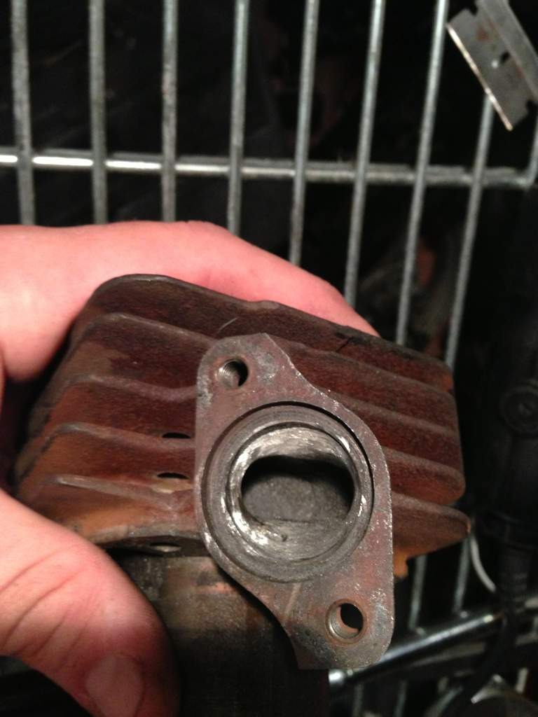

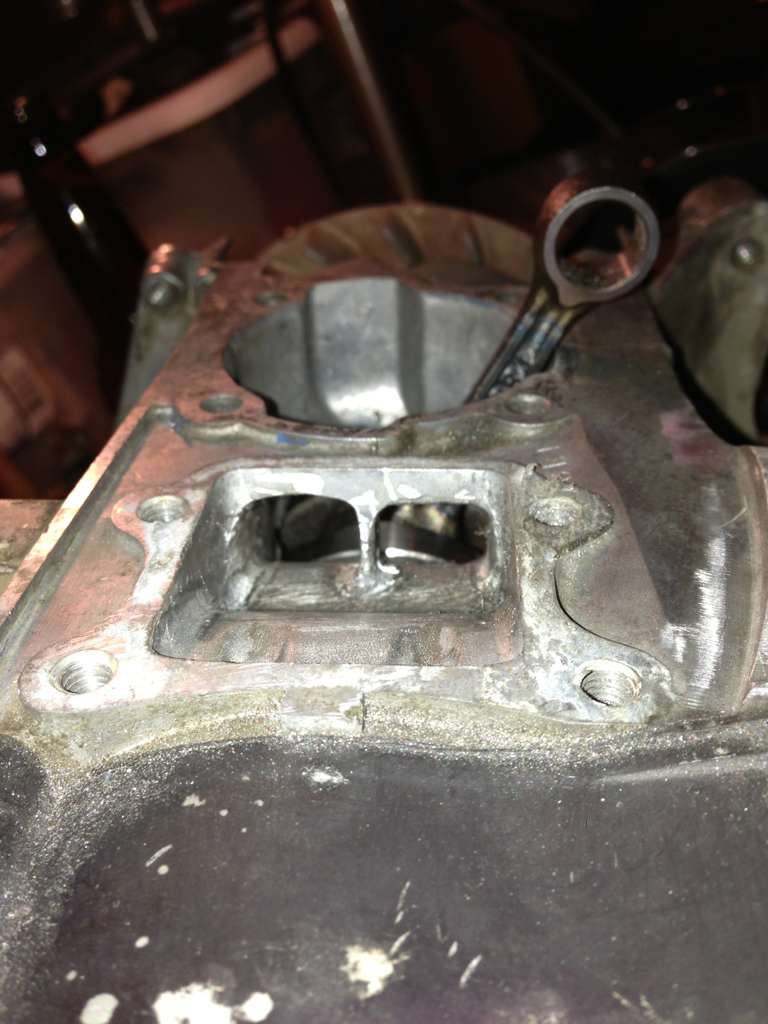

Couple pics of my port job as well only my second go at it so take it easy lol.

Before shot
Did the exhaust port of my stock cylinder jug also.

Wow curt looking pretty good! Now you just need to pull the trigger on that replacement metrakit piston and you will be ready to rip.
