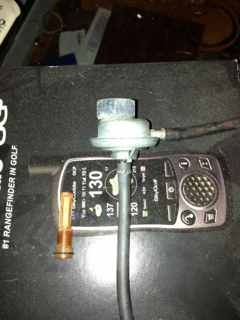

I've got a nice working petcock and filter in good condition if your interested. Off a 87 aero 50.

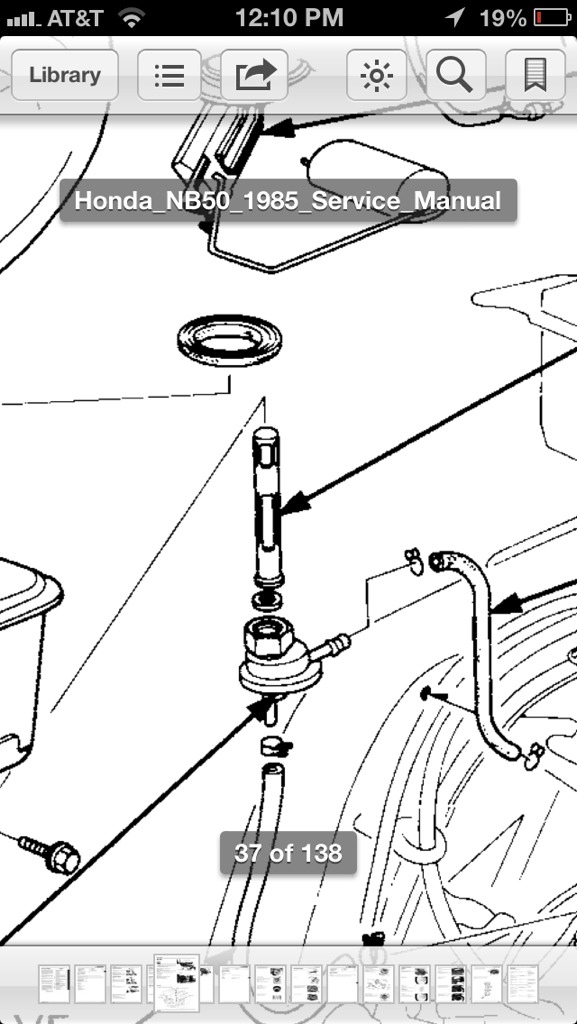

Thanks for the offer but I'm in the UK and the postage would be more than what I can get one for here. However your picture is very useful. On mine there is a thin metal pipe which the filter slides on to and then a clip and a little air filter goes on the top. From your picture there isn't one? Do I take it from this that that bit is not required?

Hmm not sure on that one. This is the only petcock I've pulled I guess. Never been inside my aeros tank.
Manual pic but I can't tell.

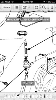

Petcock
Posted: Sun Dec 02, 2012 12:12 pm
by curtis966
Little bigger

Have a look at the petcock on the link above. It exactly the same as the schematic pic you posted except you can see the pipe I describe. However if the one in your pic works which it will it will explain why all the new ones I can buy dont have the pipe.
