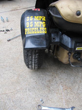

In the pursuit of a wider stance on the rear tires for tighter turns and eventually wider tires by installing 3" spacers.

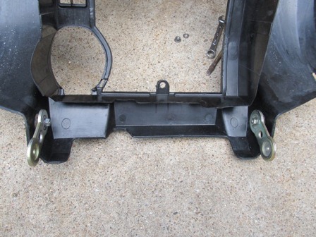

To accommodate the tires not rubbing on the engine cover, the cover was raised 3/4" using brackets.

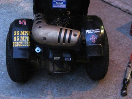

Before Install
Before
Before

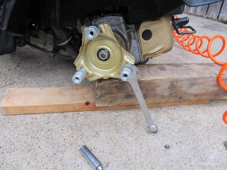

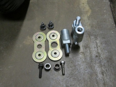

Hardware used:
4 brackets w/4 nuts, 4 lockwashers, 4 fender washers, & 8 bolts, .
6 wheel spacers for a SUZUKI KING QUAD LTZ400 LT80 ATV - http://www.ebay.com/itm/180305920100?ss ... 1439.l2649
Instructions:
1. Remove tire.
2. Remove wheel rubber spacer.
3. Remove Muffler & Engine cover.
3. Install wheel Spacers and wheels. Honda Odysseys have 3 lug hubs and should fit for wider tires.
4. Install 4 brackets to raise the engine cover 3/4".
5. Install Muffler.
6. Install engine cover, Install the rear bolts 1st, then install side bolts & ride.

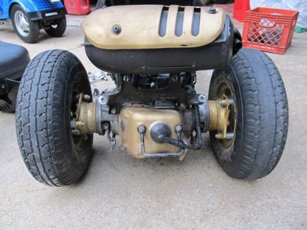

Ride results: No loss in speed. Better cornering stability. Softer ride.
After pic.
