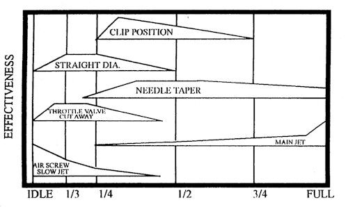

Re: 24mm oko
here is a chart
as you can see the main jet doesn't have much effect until 1/4 throttle, you should be playing with your air fuel ratio now.
