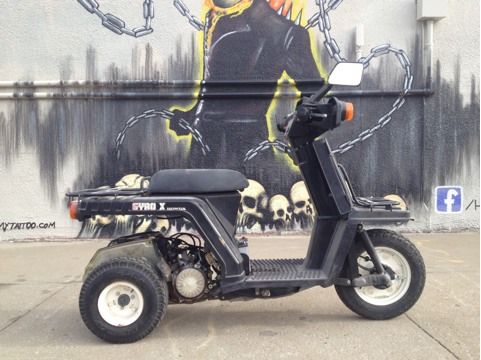

Hey all. Been a lurker here for a while; first post.
I scored a Honda Gyro X last night. Pretty rare here in the States. CVT, differential rear! It's a bike I've always wanted, so I don't feel too badly for paying more than I would have liked. Does anyone have a manual/schematic for this thinger?
The top end was off when I bought it, and stupid me wasn't careful when moving it and I cracked the piston. Anyone have a cheap stock Elite (DIO?) piston I could try?
Anyway, super pumped to finally have one of these. I'll get a vid when it's up and running.

Re: Piston - IRC Gyro X has slightly different bore/stroke than AF05 and AF16...
40.0×39.3 Gyro X
41.0 x 37.4 Elite SA50 - 88-93 (AF05)
39.0 x 41.4 Elite SA50 94-up (AF16)

Looks like the bore/stroke is almost dead-on for a Honda Hobbit. I have a spare top end of one of those here that I will try out.

Yeah I've looked around all day for tech specs on the X, Mouse, but no luck for me either. Saw that Malossi kit- tempting! I'll probably stick with porting the stock Gyro cyl., pipe it, reeds, maybe up-carb and call it a day.

Ok, looks like Gyro X top end is probably the same as the Aero 50. Off to part scour.
Re: Honda Gyro X score. Need a piston!
Posted: Wed Jan 09, 2013 12:07 am
by manthone
Sorry- '83/84 Aero 50 to be precise.
