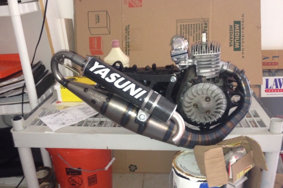

Hopefully someone can give me some good info.. I feel like ive tryed everything..setup is stage 6 racing cylinder,stage 6 racing crank, yasuni c16,ct mani ,oko 19mm..thing idłes beautiful.. Compression is at 125.. Now ive tryed different heat range plugs ngk 7-9.. Different jetting combos pilot and main..different base gaskets also,, heres the thing.. Idles fine any throttle its sounds like detonation and backfires out the exhaust.. No matter what ive changed around.. This backfiring and not being able to go anywhere over 1/4 throttlle has not changed.. Any ideas guys?

Needle for me is on the bottom clip .. The thing is with mine, nothing ive done had made a change.. From the very first start up to now after all the stuff ive done, differnt needle clips mains pilots.. Base gaskets..king no leak test..all grounds are good.. Reeds yea i checked em out looked good.. It just seems like its loading up with fuel..like super rich..fresh gas and 32:1 but that seemed to be alot of oil you could tell.. Leaned out on the oil and put a fresh tank.. Same thing..this ones testing my little bit of skills here

dam thats a nice pipe where did you get it?
