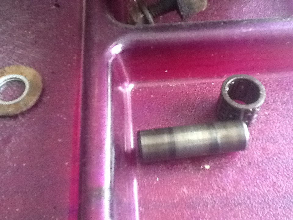

- Looks like it got hot?
- image.jpg (248.22 KiB) Viewed 4206 times
- The jug has one spot that looks problematic
- image.jpg (162.63 KiB) Viewed 4206 times
- Piston has some scoring. About .01 at largest
- image.jpg (161.34 KiB) Viewed 4206 times

I'd look at how much tuning you want to do. If you just want to restore the lost power and not have to mess with then I'd go rings and possibly a piston. Go out and spend the 8 or 10$ on the brake cylinder hone, hone it to the nice cross hatch see how the bore cleans up. Then clean up the piston or replace it, clean the groove and cross hatch the piston (if reusing old one) a little and give it new rings, bearing, pin and circlips. Assemble with new gaskets and break it in.
I'd replace the piston now that I look more closely at it. Looks like it was soft seized pretty good. Which was what probably caused your being stranded by sounds of it. I would make sure you check the intake system very carefully for air leaks and such. And make sure the screen is not blocked in the tank and fuel flows freely. Also make sure its getting oil properly. Sometimes adding too much oil to the fuel tank when using the oil pump can cause it to run lean if you don't up jet.
