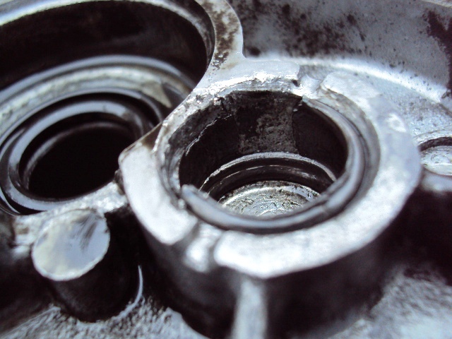

The needle bearing pictured below was very long-lived...28 years.
I considered that these needle bearings might be located in the crankcase fiche, regardless of how LITTLE sense that made.
I acknowledge the bearings as being standard as indicated by the #'s
All ball-bearings in my trans are seemingly undamaged,... :eyeroll: ... but I consider it a risk to continue to use them after being run in the gear oil with needle bearing debris permeating the whole mess.
That needle bearing debris did a major number on the gears and concerns me about the possible damage to all components.
Ruby gears 009.JPG (145.33 KiB) Viewed 20442 times

That bearing looks even more worn through than mine was....

Interesting. Well, at least you don't have to worry about removing the bearing... it's already 1/2 way out.
