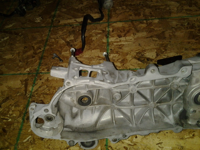

so i have never ported anything and will probably be buying my first drimil or air powered grinder today
i have my head off, my engine out, and my case split.

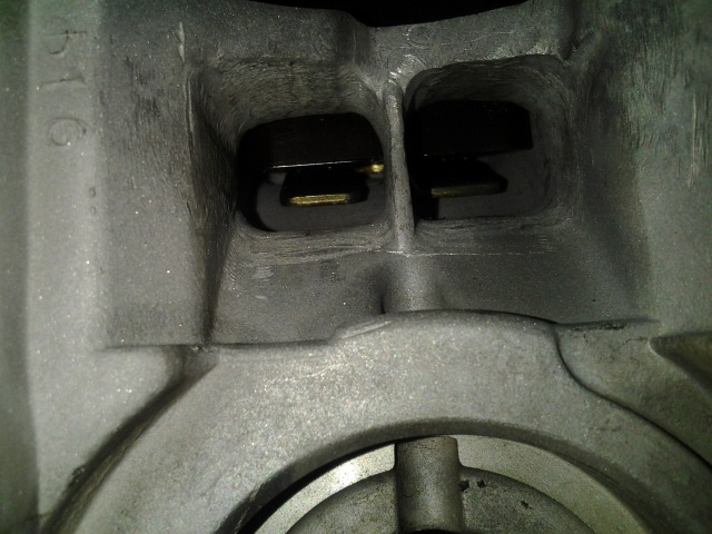

what can i port? looking at the cylinder, porting the ports that are on the cylinder wall seems terrifying but i think i could open up the exhaust flange quit a bit, but would it make a difference? ( i have a leo vince pipe)
looking at the intake, ive ordered an aero80 reed cage and intake but its not here yet... looking at the case i split open, it looks like i could open the intake ports up quit a bit but is there an advantage to this?

how about the intake ports in the case? im guessing just chew away. it kind of looks like i can take out alot on the top but the bottom is not very thick and will go through the case.

Re: what to port? (af05e aero / elite )
You can make the case's intake ports a little wider and as you said taller. Also you can knife edge the piece that comes down in the middle.

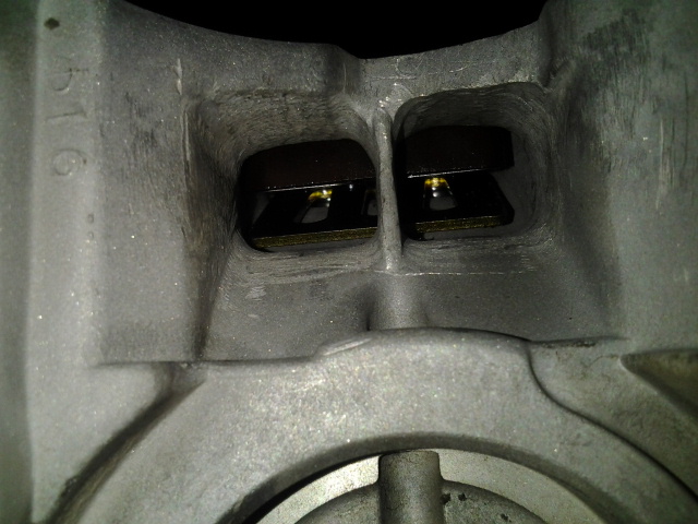

i ported the intake on the case and the exhaust on the cylinder. its really hard to measure, but from what i can measure, the intake ports increased by 3.87mm virically no way to get a horizontal measurement.devenex wrote:hate to break it to you, but you can't really port for power, fuel economy and reliability. FE and reliability go hand in hand, but angling for more performance beyond a certain point will affect the previous two features.

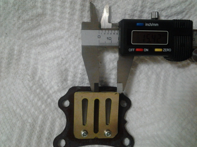

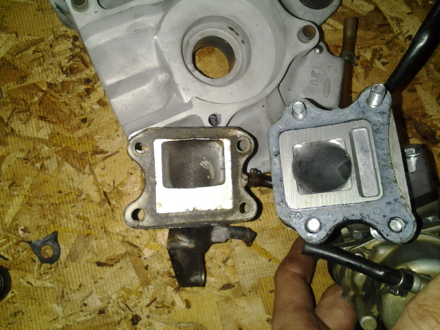

so as i mentioned im putting an aero80 reed cage and intake on the block. but it seems as if the aero80 is bigger in some ways and smaller in others. i kind of feel like i should put the aero50 reed stopped on the aero80 reeds. what so you think.
i also sand blasted the case
the aero 50 reeds look like they open up way more! ideas?

- patthesoundguy
- Posts: 3019
You can always bend the stopper. I do it, just bend the stopper to only have a few thousands clearance to the case. I've been told that by a really experianced 2 stroke engine builder, and read it many times years ago. It really helped my spree.
