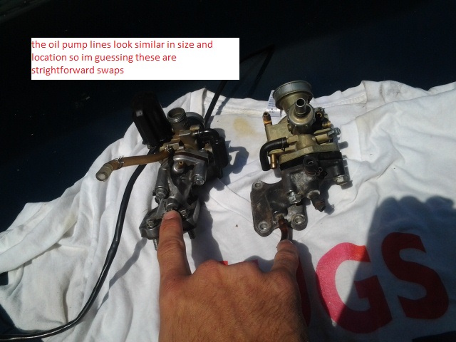

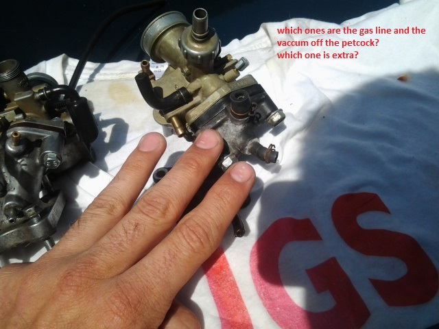

i am swapping a aero 80 carb and intake on my scooter, however it is unclear what goes where as far as connecting hoses.
any ideas?

I would check out the aero 80 manual it should give the hose locations. I had my carb off my 80 a month ago and I can't remember what went where. A couple of those hoses are for the bystarter. Which you can use a simple valve to make a manual setup.
This diagram should help
http://www.cheapcycleparts.com/model_ye ... carburetor

So i went ahead and bought the vacuum thing that is missing from the original aero80. my remaining 3 plugs and the carb go into that so it should be plug and play
