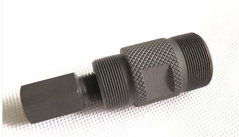

sicks in wonhttp://www.ebay.com/itm/Multi-Combo-PUL ... 97&vxp=mtr
This handy item has all of the following sizes in one combo tool (see photo):
M10x1.25 Right hand threads 10mm
M14x1.5 Right hand threads 14mm
M16x1.5 Right hand threads 16mm
M18x1.5 Right hand threads 18mm
M24x1.0 Right hand threads 24mm
M27x1.0 Left hand threads 27mm

thank you tuserv thats it

I think 24mm RH thread covers all Honda Spree/Aero 85-87/Elite SE50, SB50 and SA50. Yet Honda 50cc flywheels are not always 24mm - Gyro uses 27mm LH and eliteguy50 says 27mm LH fits Ruckus.
I'd recommend a dual 24/27mm tool at around $15-$20. 27mm Left Hand will also fit the QT50 in your avatar.Ebay Link
Pic is from seller's thread:

boy that what (she )and im looking for ... ill bet there a fue guys on here that wood not mind speeding a fue dollers on that .. thats the kink of info that shood be on here somewhere..
thank you big time :happy:
