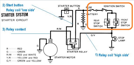

> Depressing either brake does NOT cause the brake light to come on
See diagram below. At least one brake switch must be activated to provide power to the starter relay coil. Since the scooter is suddenly not starting and the brake light is not functional, that's a good place to focus upon.
-- Generic starter power troubleshooting --
Use a test light or DMM for troubleshooting numbers match the picture.
1) Relay coil 'high side'
Connect test lamp to G/Y at the starter relay. Turn on ign, Pull either brake handle. Test lamp should light.
2) Start Button/Relay coil 'low side'
Connect test lamp to Yellow/Red stripe wire at starter relay.
a) Pull the handbrake with ign on as in test 1. Test lamp should light.
No light? - bad relay coil, broken wire connection.
b) Keep the handbrake pulled, and press the 'Start' button, test light should go off. Light on --> fix starter switch or wiring in start button circuit.
3) If the above tests were ok, put test light on Red with White stripe wire on relay output, Activate brake and start button. No power -> Bad Relay

Currently I cannot get the g/y to get the test light to go on at all. It appears there is zero power coming down that wire. Any other suggestions? I will trace this diagram out now and see if I am mossing something.
That's good - there are not many areas left to troubleshoot. Components in the Orange and ground in the pic below should cover it.
1) On the off chance there is a ground issue, your test light should have one end on the battery '-' terminal rather than frame or engine ground
2) Check your other electrical accessories - Horn, turn signals and taillight. If all are out then look at the fuse and ignition switch
3) If all above is good, check each brake light switch, and connections to the stop light/relay coil.

The black wire going into the assembly was live on both sides, but the g/y coming out on both sides is dead.
G/Y dead points to a switch issue on both sides, good troubleshooting :thumbwink:
And finally, If confirmed - Do I have to buy an all new brake assembly? I didn't see a way to remove that switch.
The switch can be pressed out. BTW - I may have missed it but what model scooter is yours?.
Remove the brake lever, then press the from the wire side. You can use other brake assemblies for switch donors. Common controls like the Spree make lower cost donors than rare scooters. Wire splicing may be required to get the correct connector/wire length.
I would also like to note that the rear brake switch smelled like fried plastic - so I can only assume that its fried on that side at least.
That's the smell of doom. Be good to double check your fuse is the correct value before firing up a replacement switch. If the corrrect value fuse is blowing when the brakes are applied, likely there is a short in the stop lamp circuit.
If fuse is correct value is is possible that brake switch contacts were worn/high resistance. Given that, they could heat up and melt switch internals.
