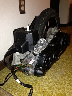

She's all labeled, painted with matte heat-resistant paint and ready to go!

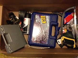

My tools and box of 'stuff' used for the overhaul.
Old NQ50 and parts in a box... Anyone want them? haha!

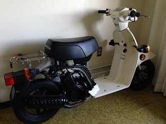

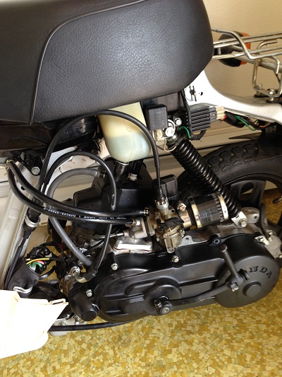

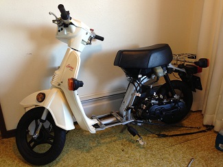

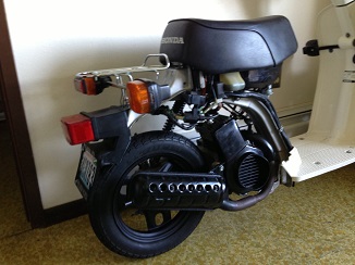

So hoping this pays off... Looks a lot meaner than the old NQ50 for sure!
Nothing connected yet, but it's coming together!
She's in!
She's in!

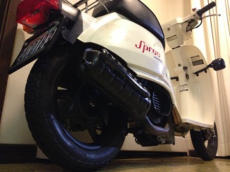

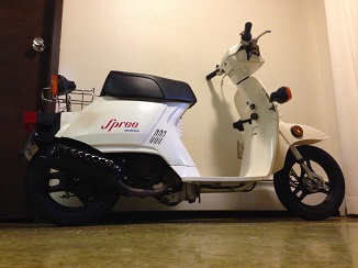

Oh man, that was fun! Just took this bad boy up and down the street... Hit 35mph no problem! Now, I pose this slew of issues:
The bikes starts fine (via kick start), but the electric motor chooses when it wants to and not want to engage. Battery issue possibly?
The bike runs fine, but it won't idle. Is this a carb adjustment, cable adjustment... etc?
Thanks ahead of schedule for any help!

You should be able to fix your idling situation by adjusting the carb screws, just make sure to get it warmed up first so the bystarter isn't open when you set everything.
Also might want to trim that mud flap in the back LOL!

devenex wrote:You should be able to fix your idling situation by adjusting the carb screws, just make sure to get it warmed up first so the bystarter isn't open when you set everything.
Haha, yeah I hacked off a good amount from the rear fender... It's 'cafe clearance' as I'd like to call it! Good thing I only weigh 140lbs haha!
As for the carb screws, I've done the 1 7/8th's of a turn trick, then run the idle all the way in, all the way out and everything in-between. No luck...
