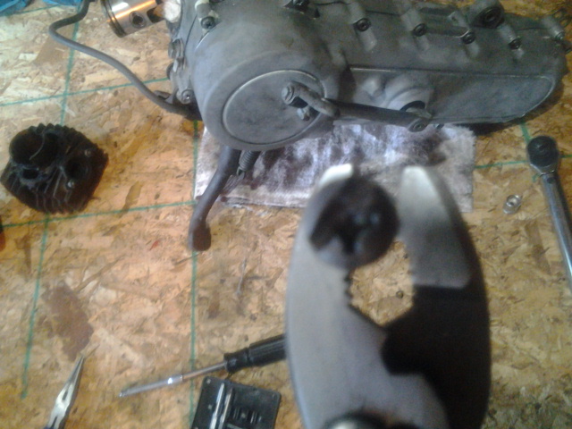

3.) speciality craftsman tool designed to removed stripped screws.
- worst craftsman tool i have ever used, made my situation much worse, no matter the pressure and the speed.

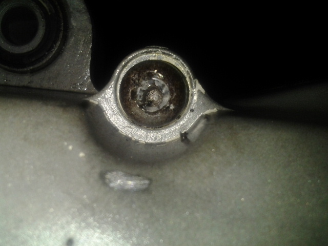

- Stupid craftsman tool....
- 2013-06-04 19.54.46.jpg (106.82 KiB) Viewed 6958 times
- Stupid craftsman tool damage ....
- 2013-06-04 19.55.05.jpg (82.71 KiB) Viewed 6958 times

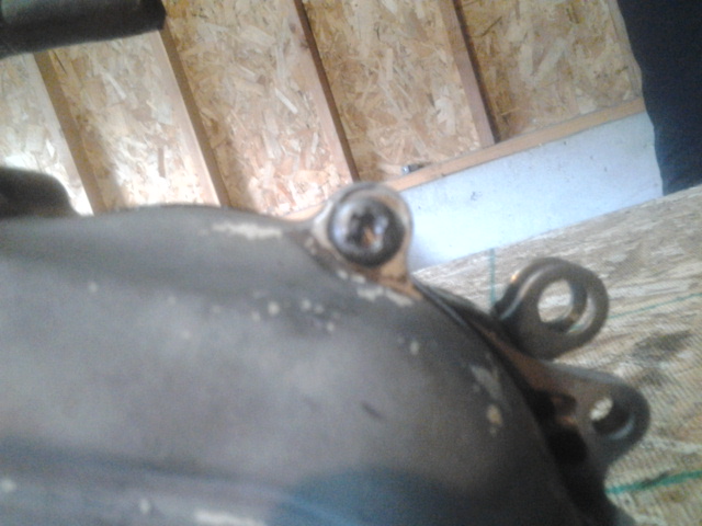

- Stupid screws...
- 2013-06-04 19.55.26.jpg (107.85 KiB) Viewed 6958 times

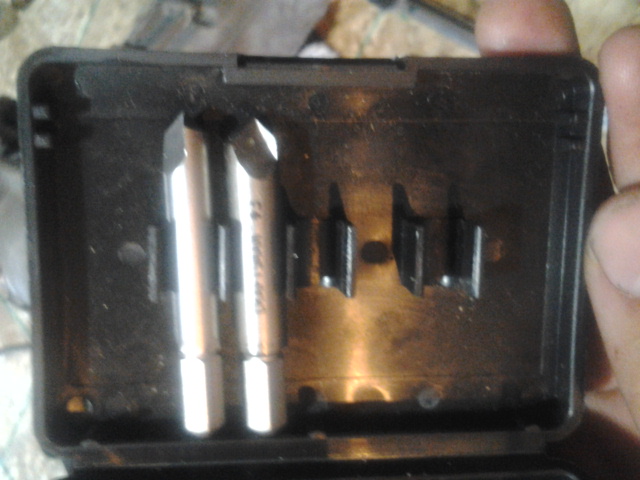

- self made off cenerter and yet superior flat head.
how embarrassing that an meadows sized flat head works better than a honda sized philips - 2013-06-04 19.56.22.jpg (136.66 KiB) Viewed 6957 times
