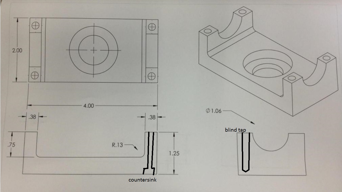

[quote="graphite9"]ok, here are the preliminary sketches of the BMX handlebar clamp. Plan on it being billet. Any suggestions on other billet parts?
[url=http://s45.photobucket.com/albums/f96/b ... 7d31b5.jpg][img]
I would say make the .38 dim where the bolts go through wider depending on what size bolt you would use
than in the top part of the clamp use a countersunk socket head screw would make for a cleaner look
than are you goin to thread the bottom part of the clamp ?
just a thought
or to make a really clean look
blind tap the top clamp blocks
and countersunk the holes from the bottom of the clamp
sorry about the butcher job but like this
just a thought
Paul Jug
