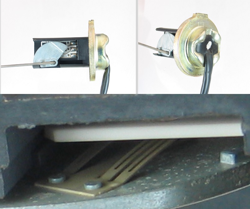

Here's some pics, I have only a 2 wire sender handy, but the moving parts should be very similar.

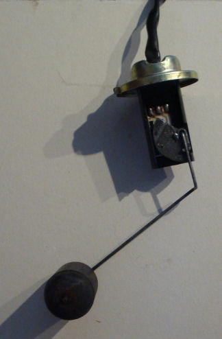

My unit is different all together here are some pictures: Maybe they might help : If Ia can get a picture of the contacts it will help me to construct new contacts.
- resistor (works)sm.jpg (29.68 KiB) Viewed 22119 times
- contacts missing-1sm.jpg (24.43 KiB) Viewed 22119 times
- Complete unit ( three wires)sm.jpg (32.01 KiB) Viewed 22119 times

The change from 2 wire to 3 wire sensor in our 50cc scooters was apparently a big change to internal construction. 1998 Elite SA50 looks similar to yours. Your idea to grab the contacts from a 50cc scooter looks goodMy unit is different all together here are some pictures: Maybe they might help : If Ia can get a picture of the contacts it will help me to construct new contacts.
Contacts are redundant and independently sprung, pretty small work. if you make your own please post and teach us about the process.
Photo: 1998 Elite 50 fuel sender:
-- Electrical comparison --
Service Manuals show the 3 wire Elite SA50 sender resistances are close, but not exactly same as Elite150.
1985 Elite 150 was a 2 wire sender and resistances are close.
- Fuel_Sending_Unit_Elite_150.jpg (201.06 KiB) Viewed 22113 times

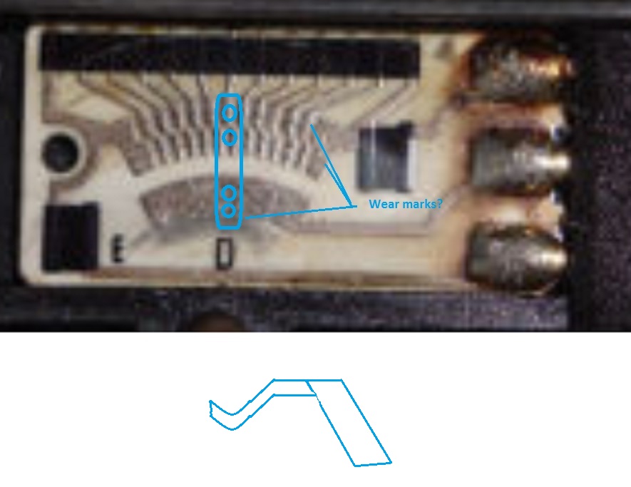

Thought about a full teardown, but figured I'd damage or loose the press clip on the shaft. I took apart my running 1998 Elite to get the sender pic. It's all buttoned back up nowTo get the float-arm and the piece that holds the contacts on you have to remove the small spring washer that holds the float arm on (Just get finger nails behind it gently pull and turn it) it then just slides off the shaft. to put back on , take small pliers and slight squeeze the spring washer so when you push it back on it will have again a tight grip.
The contacts sweep as you expected. Before getting a look at the sender, I looked at your pic and made a sample of what needs to be connected, and a stab at a contact. It ended up being a mirror image. The mounted part should be on the left side.
Floppy disk covers are stainless steel, make sure there are no burrs on the contact surface. Burrs will likely cut through the conductors of the PCB.
BTW - The Elite 50 sender is the same part number from 1988 to 2001, 37800-GS7-671. New, its $60. You could put a posting in the Wanted/For Sale section for a used part.
- Fuel_Sending_Unit_Elite_150_resistor.jpg (86.68 KiB) Viewed 22081 times
