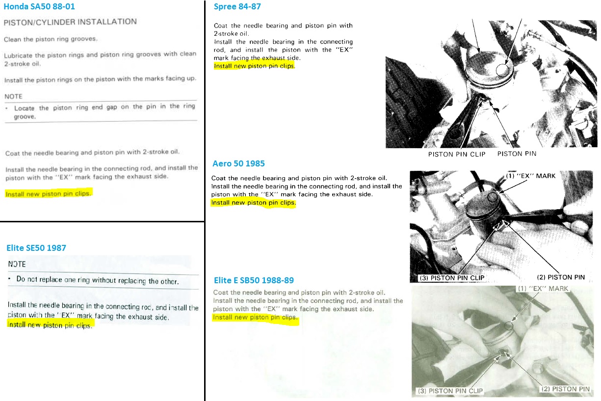

Re: What not to do when installing a BBK
Posted: Thu Jun 27, 2013 12:03 am
Honda service manuals present consistent guidance:
Here is a cut/paste to burn it into memory
