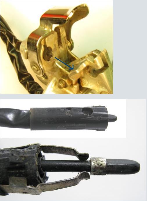

Alright, I'll try to borrow a voltmeter from a friend. Since it's probably the brake switch, where is that located? Is that the part that actually comes into contact when you pull the lever? Would I have to replace the whole right hand side then?
Re: Brake light issue.
Posted: Fri Jul 05, 2013 4:53 pm
The brake switch is a light press fit into the control lever base. You can press it out in the direction indicated in the pic.
Search eBay, there are aftermarket replacements, or ask in Wanted/For Sale for a switch.
