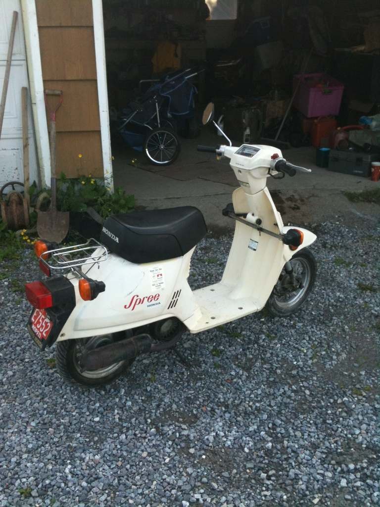

For starters I am feeling really excited to be getting my old Spree back! It had stopped running and then I moved to a different city but it will finally be making its way back to me.
So after looking through the wiki it sounds like i may have some work to do on it for sure but i am curious if anyone on here has a good idea about what i should be expecting once i have it all opened up. will i have to replace a lot of rubber parts that maybe have dried out? what kind of cost should i expect? or do you guys think it has been sitting to long and it is a lost cause (which i'm sure and i'm hoping is not the case)?
also i am really not mechanically savy for the most part so if it gets to be much would it better to take it somewhere or should i be able to figure it out with the repair manuals?
Thanks in advance for helping out this new member and for maybe getting my old spree back to life!
