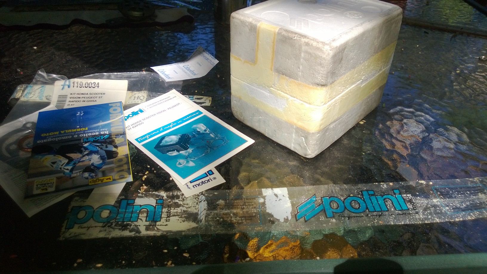

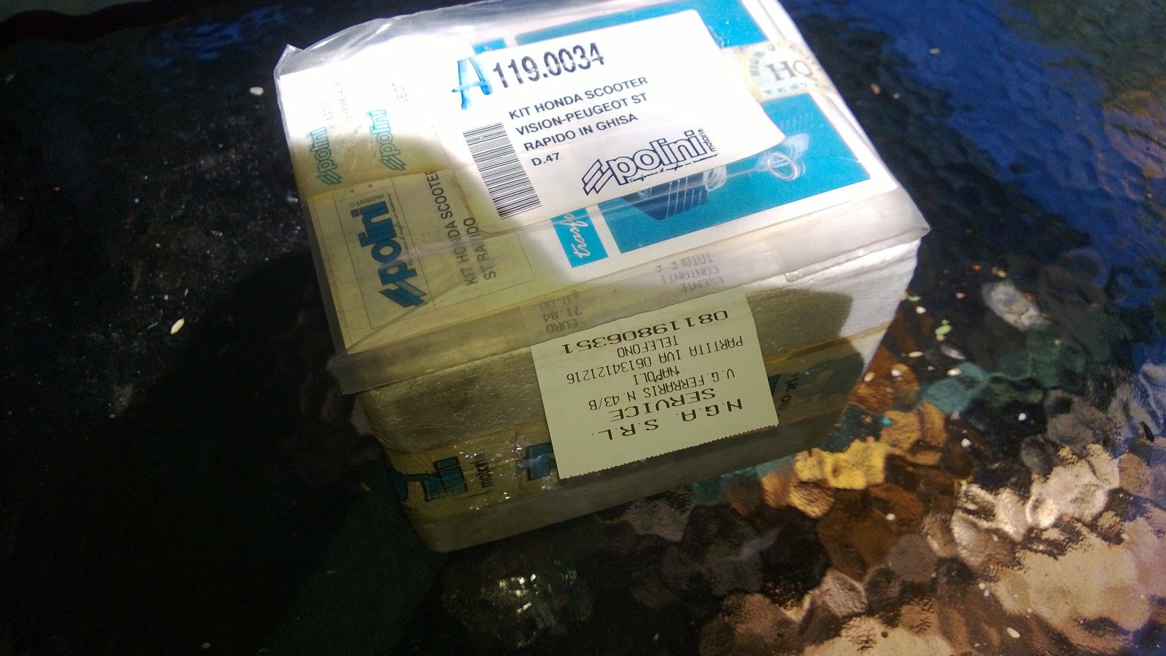

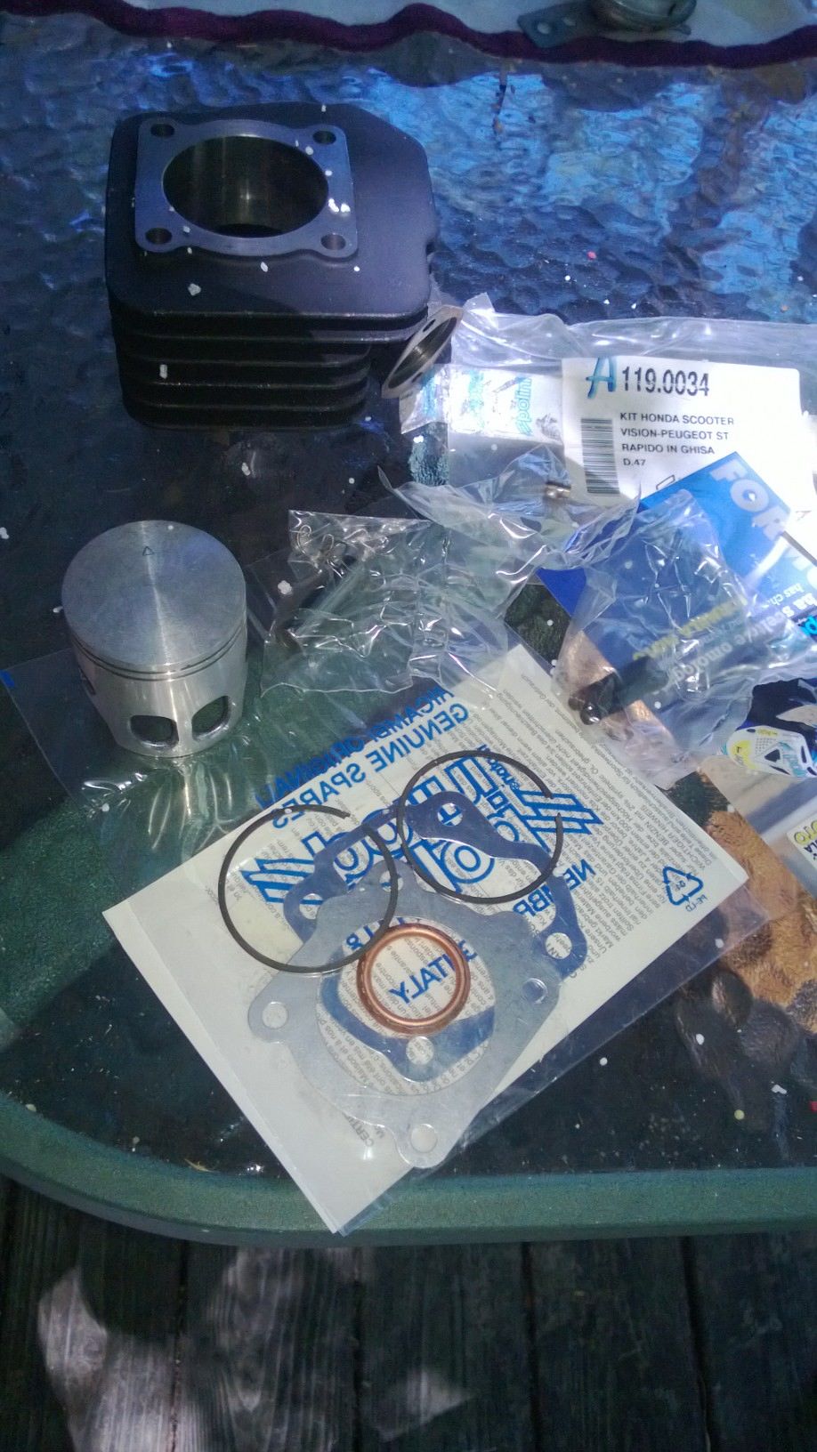

i went out on a limb and bought this kit, it cost 92 and change shipped. looks like you retain the stock head, but it shipped on the 11th from italy and i got it today (15th). jeez thats impressive. looks like the exhaust could use a port. will be installing tonight or tomorrow let you guys know how it goes. also could someone tell me their experience breaking this in properly. thanks!
included:
base/head gasket
rings
jet (size not stamped)
wrist pin
circlips
exhaust gasket/studs
stickers :lol:
http://www.ebay.com/itm/350826465440?ss ... 1497.l2649

Also is this for your af05? If so measure the piston. I'm pretty sure it will be a ~65cc kit if its for the 05.
crimespree
Posts: 69
Joined: Sat Apr 02, 2011 12:44 am
Location: Portland
Re: wow polini 72cc kit 92 shipped!
Post by crimespree »
I measured the cyl. It is 47mm. Does that make the piston 45mm=65cc? Or does the measurement come from the bore? Paul there is no stamp. Jet is 90. I'm going run a uni pod so I think I should probably upjet. Any of you guys have a similar setup to get me pointed in the right direction as far as jet sizing goes
47mm bore multiplied by the shorter-stroke SE05 crank defines a fat but short cylinder whose volume is 65cc. SA16 cylinder is 41.4 mm tall, thus holds more. Volume is determined by the size of the box, or cylinder, in 3 dimensions.
