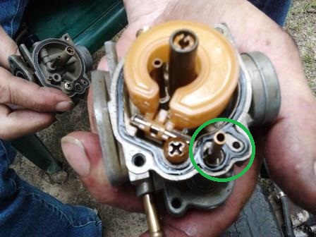

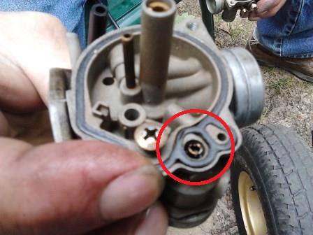

I do have a question that someone may be able to answer. I have an 85 Gyro S that on first start up will idle fine, I will take it up the road and come back, (maybe 1/5 of a mile) and then it does not want to idle at all unless the idle screw is messed with. Once adjusting the idle screw I will take it back up the road (same distance) and when I get back it doesnt want to idle again. Bought another card off same year Gyro S, and found that there was a tube broke off in the bowl. In the photos you can see what I am talking about. Red is the new carb and green is the old one. Is there any way to take that tube out of the old one and put it in the new?
New Carb
New Carb
Old Carb.
Old Carb.
