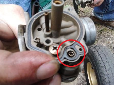

So I have a Honda Gyro S, and it has always ran really well. This spring I took it out of the shed and cleaned it out like normal, started it up fine, and ran it about 1/5th of a mile down the road and back. When I stopped it did not want to idle unless I played with the screw. Once I got it idling, I took it back down the road and when I stopped again it didnt want to idle like the first time. So I took it apart and made sure everything was working properly and hooked up right. It all was. Then When I went to take off again, It was like it was stuck in first and wouldnt accelerate past 17 mph. (A little adjustment with the high speed screw fixed that.)

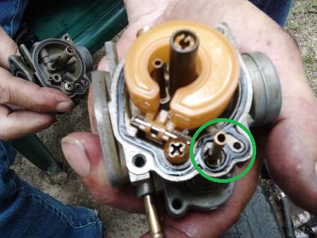

So I assumed that the not wanting to idle had something to do with the Carb. So I went on ebay, bought one off the same model from "b4uc8r9" in which I do not recommend you purchase anything from this guy. Got the carb, cleaned it out, put it on, and it wouldn't idle at all, not even with adjustments to the screw. So I took it apart, and found that the Fuel Mixing Tube was busted off(happened before we got it, you could tell it had been like that for a while) Now when riding the Gyro with the new carb on, it ran the best it had in many years. But would not idle and took almost full throttle to start. If anyone could take these symptoms and make give me a diagnosis and a prescription for what my bike has, I want to get this thing on the road.

The tube you are working with has to do with the bystarter, which enriches the mixture when you start out but closes after runnning a little while. It's an electrically activated gizmo with a pin that moves down slowly. The replacement carb could be faulty in a different way because the bystarter pin is jammed or busted. You can remove the whole assembly easily and test it. The procedures are in the repair manual.

Take the bystarter off the carb you bought, put it in your old carb, put the old carb on the Gyro. I'll bet it runs fine and will continue to run when it is warm.

Ok, so just messed around with it some more. Took off the bystarter and changed it out. Ran the same way. Found there is a little hole next to the fuel mixing tube that I had never seen before and put a little wire in there to make sure it was clean. But when I put it all back together, i decided to see how it would run with the bystarter in the carb but kept the wires unplugged and it seemed to idle great. took it down the road and back and continued to idle for a while until it finally shut off after about 5 minutes. I think that it may have something to do with when the bystarter plugs up the fuel mixing tube after running it up the road.Garadactyl wrote:We tried this. Starting to think that it is not the Carb that is making it not idle. With the old carb and the new bystarter, it will start better (just a little throttle instead of half or full) but still refuses to idle correctly. I will try and see if maybe the Reed is the problem. Will I need to replace the gaskets once I get to the reed? Or should I just be ready to replace them in case they are bad?wentwest wrote:Take the bystarter off the carb you bought, put it in your old carb, put the old carb on the Gyro. I'll bet it runs fine and will continue to run when it is warm.
