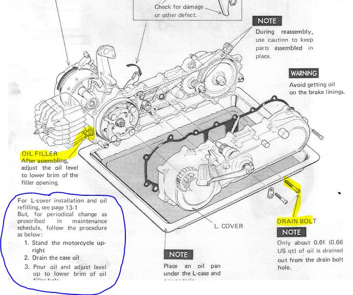

Re: Honda Express.... Where to begin
im still figuring out how to put mine back together. you have to balance it on its side, fill it with oil, crank back the kick start, then some how keep everything in place and get the case on with out spilling oil anywhere.
Did Honda delete the plug for some model years? This manual page shows an oil fill plug and outlines a method to drain/fill w/o laying the bike on its side.

the drain/fill plug is right in front on mine (just as the illustration shows) figured if it drains out of the plug should be able to fill it from the plug.

you cant get all the oil out with the drain plug, ( manual says only .65 quats will come out, but its probably " good enough" for an oil change,
however! unless you have a hummingbird beak there is no way you are getting .9 l of thick 10 weight back in the small drain hole. the physical hole inside the drain plug hole that connects to the case is a pin hole.
section 13-1 will show you putting the entire bike on its side.

Image this is the fill plug.
Image and if I remember correctly or I may be dreaming but one of these screws on the underside of the case is suposed to be a drain screw, might have been later years i think the 1980 motor i had originally on the bike had the drain screw. That motor on it now is 77 motor.

Why does it seem that mmeadows and ptsguy didn't bother to look at the schematic that mousewheels put up and HIGH-LIGHTED BOTH the DRAIN and the FILL.... :confused: :confused:

motormike wrote:Why does it seem that mmeadows and ptsguy didn't bother to look at the schematic that mousewheels put up and HIGH-LIGHTED BOTH the DRAIN and the FILL.... :confused: :confused:
:-P diddnt see it the pic took to long to show up on tapatalk and i missed it my bad. But hey I should get points for taking the time to drive my golf cart across the yard to take pics and post them right? LOL
