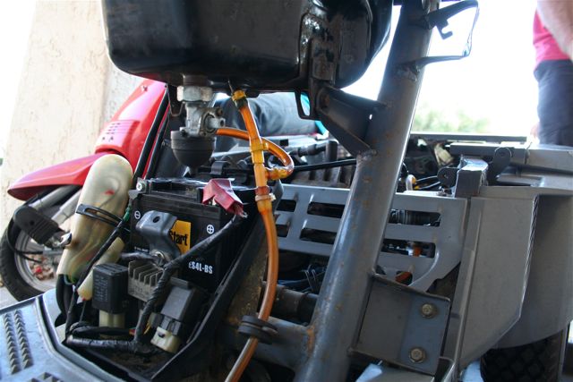

I like sharing pics, and here is were we stand as of tonite. Ended up taking her clothes off while tracing the "auto bystarter" wiring so i could test it, and this is were i stopped.
BTW, can someone explain that valve to me please. Does it act as a choke ?

Good to have you aboard with a Gyro X :thumbsup:
Bystarter is a cold start aid - gives a prime first few revs. Additionally, the bystarter circuit supplies additional air/fuel until the bystarter is warmed up. It slowly tapers off over a period of a few minutes. Wiki link -> http://hondaspree.net/wiki/index.php5?t ... at_It_Does

Thanks MW's That's a great write up. Loved the cut-away pics. Must be a common question. Pretty cool design and now that i understand how it works that explains my high idle when i started it today cold. (after i had adjusted idle the prior day) Don't think i've let it run long enough to see it idle down, but i'll give that a try tomorrow.

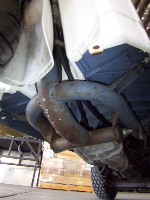

OK Glad I found this post .Yes mine looks a lot different a bit wider I would say .
Here are some crapppy pics of my bike naked .
Not even sure if the hose configuration is correct ?

Thanks for the pics. Strange how different our scoots are. *, even your car sits different than mine. I assume your exhaust was off in that last pic ?
btw, whats with the language filter on this site ? I originally used the word w.e.i.r.d. in place of "strange" and it ** it out ? :crazy:
