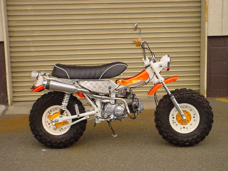

I found an example of RV90 that received a Lifan engine...hopefully you will revive the 90 smoker.
RV90-Lifan swap.jpg (107.74 KiB) Viewed 18270 times

motormike wrote:Good to see you back into the swing of things... :wink:
Wow.. That's a beauty.
I'm definitely reviving the 90cc 2 smoke with only 1900 miles I figure I can't go wrong.
