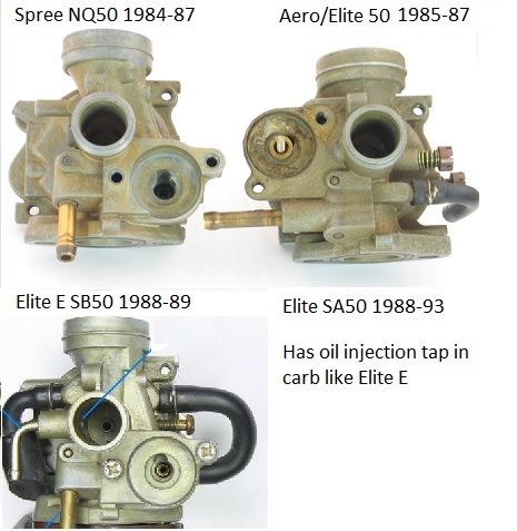

After fighting carburetor issues for the past month and a half on my '89 Elite that I "inherited", I ordered a brand new carb and it finally came in today. Much to me surprise, it looks like a mirror image of the one I had. (It's the OEM carb and not a performance type of some kind.) No problem with the fuel inlet or vacuum port being on the opposite side, but the bistarter interferes with the shock/spring on the rear wheel, and won't allow the carb to bolt up flush with the intake manifold. In searching the internet, all the carbs shown to allegedly fit a 1989 Honda Elite E (sb50),show the bistarter on the right front side of the carb as viewed from the intake opening. Mine is on the left rear when viewed from the same direction. Even the photos in the service manual show exactly the same carb that I have. (It has a "jumper hose" on the left side of the carb body.) The carb I bought came with a new bistarter, which I was going to replace, so it's not like I am out a lot of money or anything.

One is spree, one is elite 50

So which is which? I find it hard to believe that marketers would label a carburetor to fit an Elite when in actuality it is for a Spree. Don't you? If that's the case, then Honda must have sold a ton of Sprees and very few Elites judging on the amount of replacement part available. It's the old law of supply and demand which always governs aftermarket parts.
Double check the sellers listing. On my scan, they show Elite SE50 or SA50, which is not your model.
-- History
Honda Elite models in the 80's are subject to confusion. There was the Elite SE50, Elite SA50 and Elite SB50.
Your model, the SB50 was roughly a repackaged Spree. Its entire powertrain is close to an 87 Spree with a single speed drive. The other Elite 50's have a variated drive, basically from the Aero50. So be careful with any part saying 'fits Elite' to check it works with SB50.
-- A carb for SB50
Since you already have one mis-fit carb, I'd point out SB50 is not a exact "Spree" carb. SB50 has an added oil injection tap. Honda as the '80s closed moved oil injection from the intake to the carb. The other Elite 50 models got an oil tap too.

Yep. Spree has bystarter on outboard side, Elite is inboard.
And no, I think most ppl on Ebay that sell the carbs have no idea what they're selling. Honda OEM, yes. Reputable online shops, yes. Ebay, not so much.

Thank you so much for all of your valuable information and the pictures. The photo of the Elite E SB50 1988 - 1889 is exactly what I took off of the scooter, and what I have been trying to replace. I've seen a couple of used ones advertised on EBay, but most were for parts and not rebuildable (per sellers). I guess that I'll have to go through mine for the 5th or 6th time, and try to find out where the problem lies. In reading your threads, it sounds as if the air/fuel adjustment is super touchy on where it is set. Also, I have been doing all my adjusting without the air box off and sitting on the bench. When I do put it on, it starves the engine for air and kills it. I still find it hard to believe that enough air can find its way through the few, and small, openings. It goes directly against all 4 stroke theories that I have used for over 50 years of tinkering with engines of all types. I know 2 strokes are a different animal altogether, but every engine needs air to run. Gearhead friends of mine keep telling me to look in other directions, and to get the carb thing out of my head as the source of my sporadic running conditions. But when you have good compression and spark, where else would a person look? (The stock exhaust can easily be blown through with no restrictions noticeable.) Do I need to get a shaman to perform an exorcism to rid the evil spirits out of this creature? I am at a loss. Would a 750cfm 4 barrel Holly be a bit of an overkill on this application? LOL (Just kidding, of course!)
Back to the drawing board for me I guess. Maybe my old carb with the new bistarter installed would shed some light on the issue, but I doubt it. But I am desperate enough to try it though. What would I have to loose but time and a little effort?
