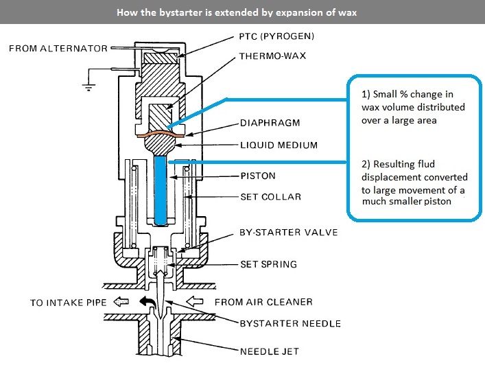

Watching the bystarter makes a person wonder how expanding wax creates the long extension.
For example, a candle burning has wax level with the sides while burning, and only a slight depression once the wax cools.
-- Pic from our 'wiki' of a disassembled bystarter showing the actuator
-- Annotated Cutaway
