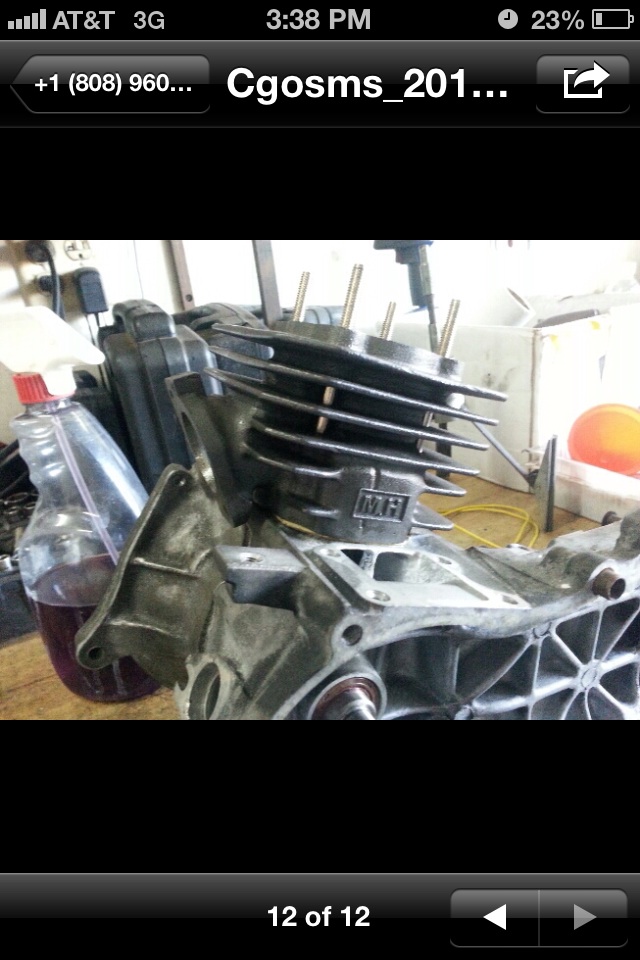

Finally done..
Post by Downsouthdio »
54mm /52.6/=121cc
Honda super dio
Corsa
26mm
Sparrow
LMH

Sweet is it running yet? What manifold are you going to use?

Thanks, havent ran it yet..but manifold will be big black ct..or kitaco

I would port match either if I was you. The ct for sure, kitaco is a little better but still casting flaws. I bet you're ready for some riding.

Port match what? Yea man so ready to ride..wana see the difference from my ministroker

I should have said smooth the rough angles rather than port match. I had the right tool in mind just not area. Im definitely full of envy of the build! Did you sell the old engine?

hi DSD. very nice work. like to see that running. :thumbwink:

Thats the bore and crank I run on my street bike. Im running Large scorp and it is crazy fast.
Did you check your port timings? The Port timings on mine were wack. I ended up machining Some off the bottom of the cylinder cause the port timings were way too high.

Vforce 3 reeds from a kx65 fit in the normal ct perfectly no mods at all. Im not sure about the ct black though. Now there are Vforce 4 out and I would get those instead. They are the same price but more flow. I thought there was some porting also involved with the black but didnt know for sure.

Wont let me post a picture of my pipe for some reason..but im using a scooter alley big scorpion..as for port timing and that i had a good fella help me out with that (tru) :smile: should be fun

Heres another

How do you fit cooling shrouds?

Gunna have to rig something up..the spark plug sits straight up and not at an angle back like most
