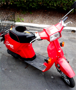

Hey guys, my name is Casey. I operate Skorch Industries down here in sunny Southern California. I purchased a 1986 Honda Spree in August of 2013, with just 275 miles on the odometer.. as of now, it has 2,669 miles on it. It's been a fun ride, but it's time to step it up.
First of all, I would like to thank a few people on this site for helping me out when I had problems. Thanks to this site, I have learned so much about scooters!
At this point, the clutch is slipping, and I failed at an attempt to upgrade the exhaust. I would like to keep this page up to post any updates on my progress.
Here is how it was when I bought it in August of 2013:

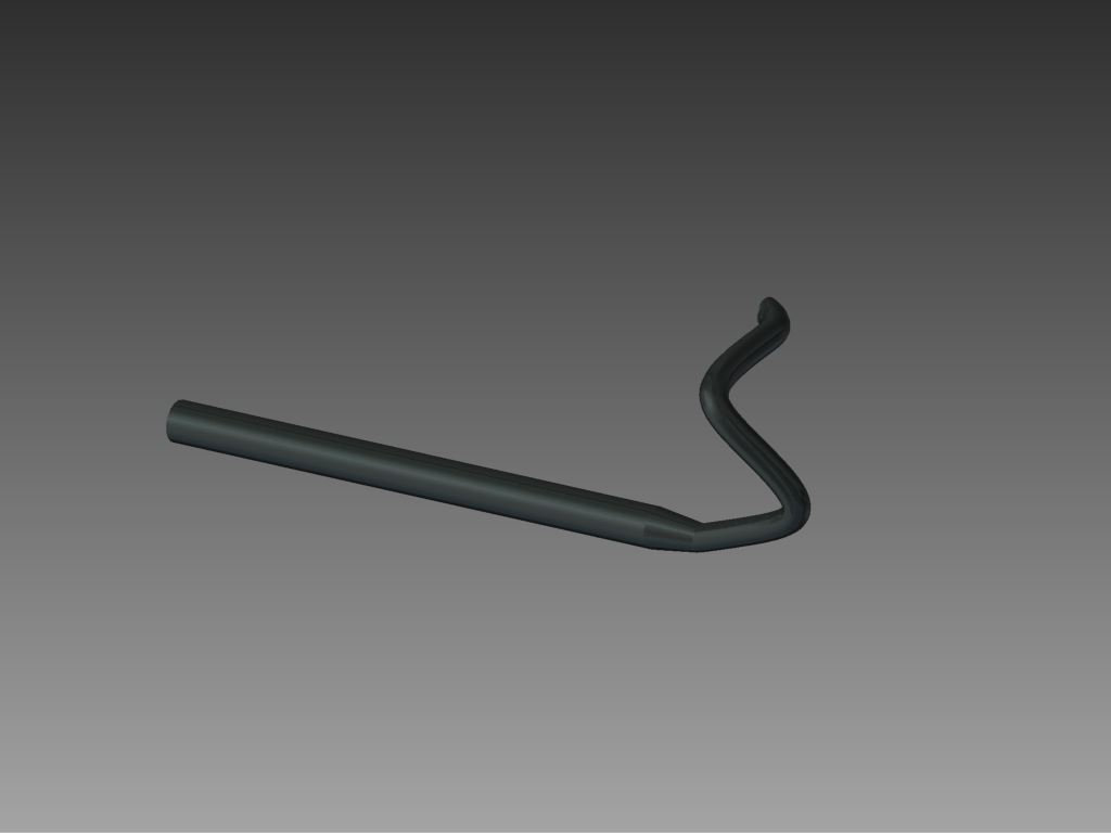

Sorry to hear your exhaust diddnt work out. Your clutch may just need to be degalzed with some 100 grit emmry cloth and cleaned with brake clean and re assembled.
for exhaust you want one of these

Thanks Pat, I got lucky when I found it locally off of craigslist for $550 last August. I loved driving it so much, never imagined I'd clock in so many miles! I'm planning on building my own pipe; I've been researching the cone shape a 2-stroke needs to return fuel back into the cylinder. The exhaust I put on it would work fine if it were a 4-stroke, but there is certainly not enough back pressure for it to run right. It runs better than when it was just an open pipe however, I had to ride 2.5 miles like that lol.

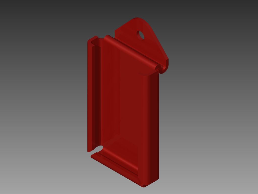

Is that a cell phone holder? Looks real neato

Yes I designed it to be made out of thin sheetmetal, do you want one? I could make it
