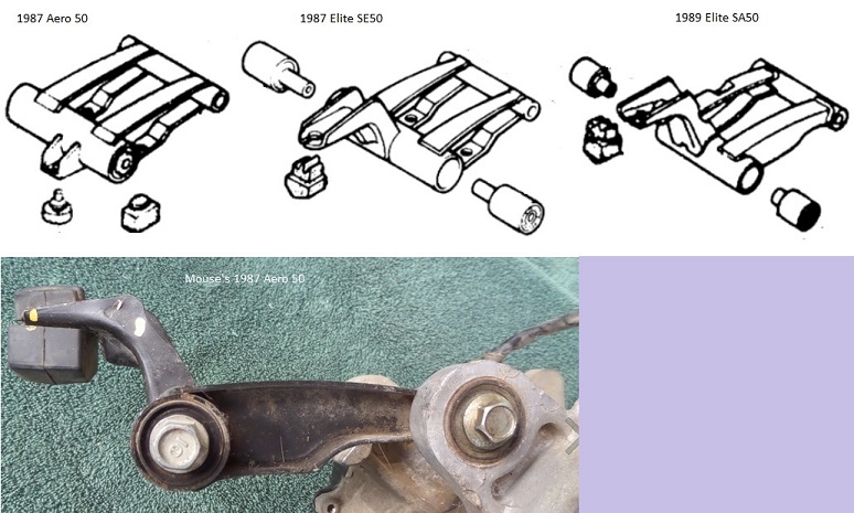

I'm not an expert on the AF05 mounts. Mystery -- I looked at Mookie's pic and thought "It looks like my 87 Aero". Here's parts fiche drawings.
Chevguy's sounds good except I don't know how comfortable if feel using the kickstand holes without some reinforcement.
+1

That's very interesting... Your 87 nb50 mount looks like a cross between the 87nb50 and se50 parts fiche pics. I checked my 85 nb50's mount last night and it looks very similar to the pic of the 87 nb50.
