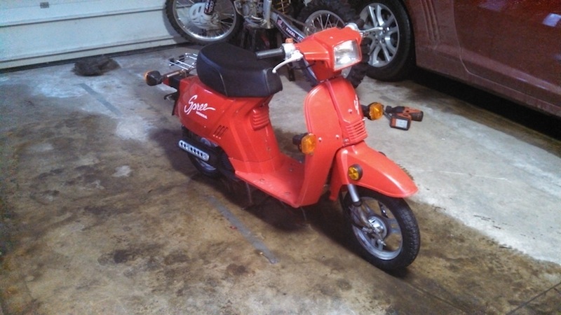

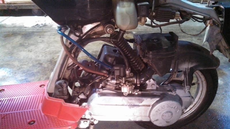

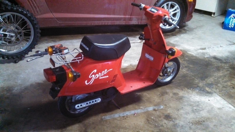

Well this is my first moped upgrade. Im new to this so i could always use some help. Bought a 85 Honda Spree yesterday. runs great. I did a little researching and notice that changing the motor would be the best performance upgrade but I decided to go with the 48mm bore kit from tazland001 on ebay. I also ordered some Michelin starcross 2.75-10 tires. plan on cleaning up some of the chrome and plastics a little. Thanks.. i throw some pics on because i know everyone likes pic

I see no moped... I only see a scooter.
- martynkim
- Posts: 2377
Re: 85 Spree upgrade
Pineapplegti wrote:I see no moped... I only see a scooter.
50cc small and not a motorcycle = moped to a noob. You know what he meant.

Nice bike! Hard to find with the petcock cover.
