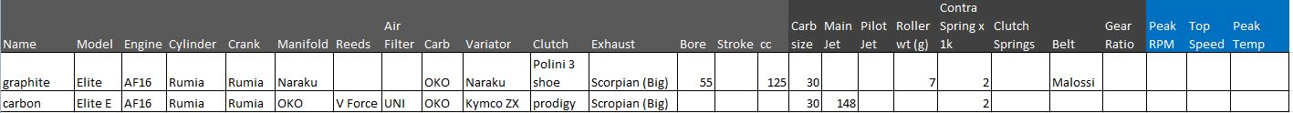

Sounds great. just not sure how to implicate this the best way.
I'd volunteer to place the data on the 'wiki as a table. It will support simple sorting.
Possibly we might have read-only access to a spreadsheet format. That would allow users more advanced filtering/sorting on their own machines.
Below is a draft table for discussion.
It is organized to capture:
1) Descriptive info (dark grey header0
2) Tuning variables(black header)
3) Results (blue header)

Looks good!
It would be really helpful to people if we did this with all motor combinations! Not just strokers

Wow, that spread sheet would make this interesting.

very nice spreadsheet. that will work.

Wouldnt it be "scorpion" not scorpian?
On this list there should be some kind of standard tho, you must have the engine running for more than a week and final tune info only not what worked one time. Otherwise theres going to be a collage of sad people using tables that make problems worse.
Certain styles of porting of the intake, cylinder, and the block can weigh heavily on jetting. The lists can be misleading as altitude and surrounding areas can heavily effect these tiny engines with huge carbs as well. Good base info to start at at least but not a decisive table to go by. I live in a very humid low land area so my jetting will infinitely be different than a good portion of the US.
Its almost like the age old question of "how heavy of rollers should I use in my variator" question. Not an easy question to answer and usually semi close.
Just an example a member uses a 24mm OKO with a 50 PJ and a 122 MJ on an af16e corsa build, my exact same set up (down to the t) uses a 42-45 PJ and a 132-135 MJ. Thats the difference between Michigan and Missouri.

there is alot of variables with this.Altho a start point for tune and finish point will help alot

HI LMH. what I meant to say is the spreadsheet will work.
I do agree a good base of info to start.
Ironic that dummy data catches me being dumby :lol:
-- General
Thanks team - good inputs for making data collection effort useful :thumbwink:
-- Density/Altitude -
Capture location or altitude?
  • LMH's suggestion to adding location helps those willing to dig generalize altitude/temperature and humidity
  • Altitude as graphite stated gives some of info and makes it easy to scan the table by eye.
-- Porting
Some are open about porting and sharing info. Some don't know - 'I raised the port about a ring width', some know but choose not to share specifics.
Here's some ideas:
  • Capture intake/boost/exhaust duration as columns. Downside is cagey and 'unmeasured' folks leave it unfilled.
  • Have Yes/No column, then comments field where shares can put specific info
-- Additional carb info
Left a couple out:
  • Throttle needle number
  • Needle clip position
  • Emulsion tube

One thing that would be worth while to add is trans type.
Whether ones using a ZX trans or af16 trans.
Looking good!
