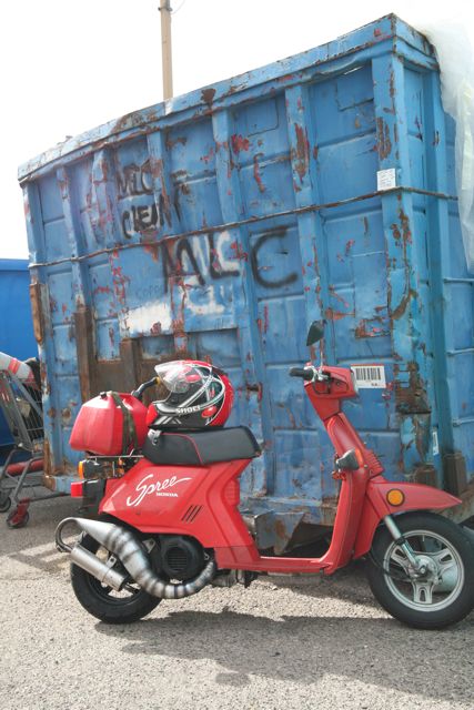

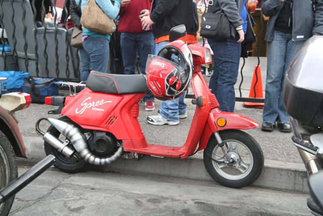

Here is what a fast Spree looks like ,not mine but a buds .
- IMG_7258.jpg (60.06 KiB) Viewed 15971 times
- IMG_7230.jpg (65.25 KiB) Viewed 15971 times
- IMG_7158.jpg (64.55 KiB) Viewed 15971 times
