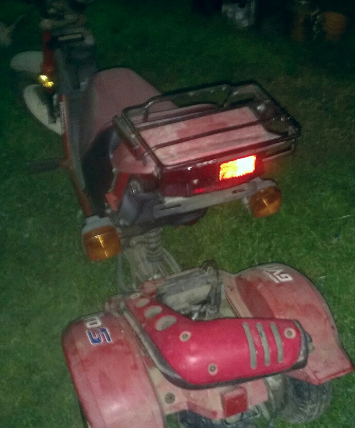

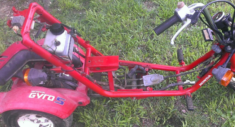

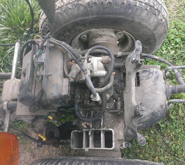

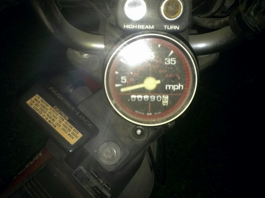

Got this puppy on CL and just got home with it plastics faded but only has 690 miles on it. The top of the piston through the spark hole looks brand new. The PO said just needed a battery and the starter didn't engage then his girl said it didn't engage everytime....guess what? The starter is missing Lmao I don't mind a lie cause I got it fir 125 and a 45 minute ride. My first gyro so I may have a few questions along the way. Can't hold a candle to 666 but imma make her shine

Pics
- tmp_IMG_20140502_062634-1399613768.jpg (142.48 KiB) Viewed 11796 times
- tmp_IMG_20140502_0625491362113408.jpg (190.5 KiB) Viewed 11796 times
- tmp_IMG_20140502_0624141183583824.jpg (189.61 KiB) Viewed 11796 times

Pics
- tmp_IMG_20140502_0643141268584656.jpg (189.3 KiB) Viewed 11793 times
- tmp_IMG_20140502_0642341111403540.jpg (172.13 KiB) Viewed 11793 times
- tmp_IMG_20140502_0645571632458319.jpg (199.69 KiB) Viewed 11793 times

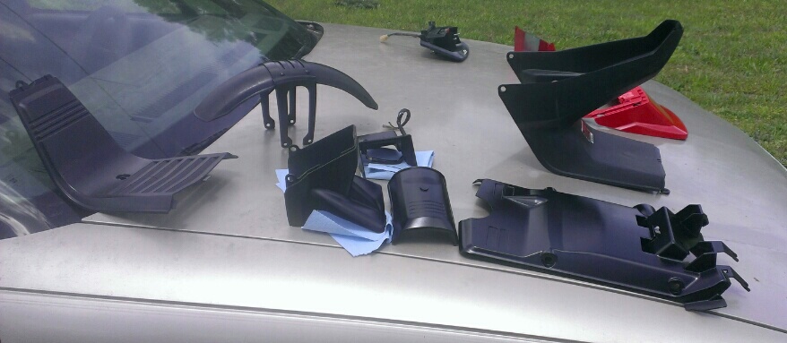

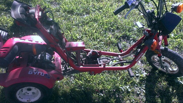

Got the oil and gas tank done with new hose. Put the backplate on and installed battery. I put some oil in the gas just to help the first run and to make sure it got oil till the pump filled the line. Got all the plastic painted satin black krylon plastic paint just like the motor fairring. Put some gas in the plug hole and after a few unsuccessful cranks I opened up the throttle abd she roared to life!!!!! Let it fill the oil line then shut it off to cool while I worked on freeing the throttle cable. Got it working alright still sticky right off idle may need a new cable. Took it fir a short spin and got her up to 30 so the Speedo and brakes work
now I gotta put the plastic back on, adjust for idle if I can cause it won't idle very well, and change transmission oil. After that imma go about a quarter of a mile to show it off lol
- tmp_IMG_20140502_0240111990043032.jpg (238.32 KiB) Viewed 11769 times
- tmp_IMG_20140502_024111-1399613768.jpg (109.1 KiB) Viewed 11769 times
- tmp_IMG_20140502_0253431362113408.jpg (216.35 KiB) Viewed 11769 times
