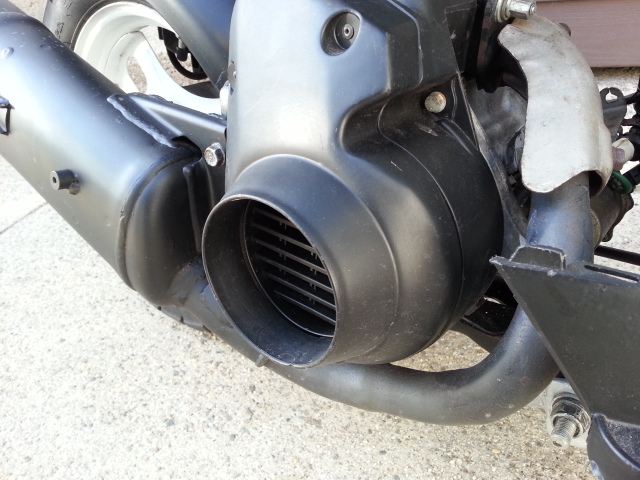

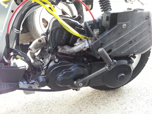

Hi forum. Take a look on page 2 for new GPS photo below May-15-14.
Hi forum.

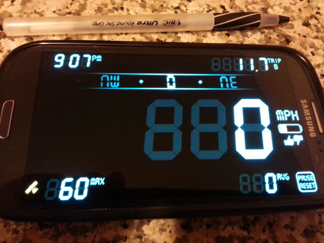

Finally some warm weather for the spreedio test run.
I set the GPS speedo on the phone and put it in my pocket.
I went for a 11 mile ride. when I stop to check top speed, 60MPH.
the ride was mostly flat except one slight hill. will retest on flat only soon.
*the spreedio
Af16 swap
Rumina stock crank
8.4
TT temp gauge (401 max)
Pre mix (oil pump plug)
Stock exhaust pipe. (drill out washer)
Stock carb (91 jet)
stock mani, reeds, air filter
old stock belt (slipping)
stock variator
stock rollers (8gm I think?)
stock tire 3.00-10
stock rear springs.
*the spreedio
Af16 swap
Rumina stock crank
8.4
Stock carb (91 jet)
stock variator
stock tire 3.00-10
stock rear springs.

hi forum.
The spreeDio was very stable at high speed.
I felt comfortable at that speed, or higher speeds. ( I'm 175 lbs.)
I took the PG Short off because it's to loud. ( no high speed testing done)
I took off the 24mm oko because the small spree gas tank, and gas hog. ( no high speed testing done) plenty of power.
I am still breaking in the polini corsa.

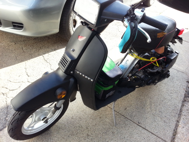

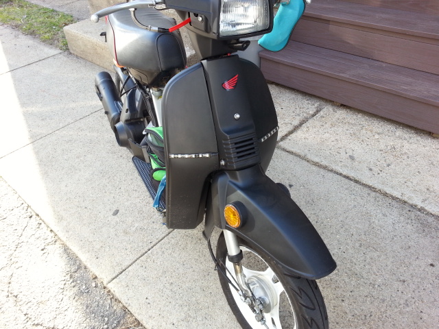

Cool ride. Is that plasti-dip paint?

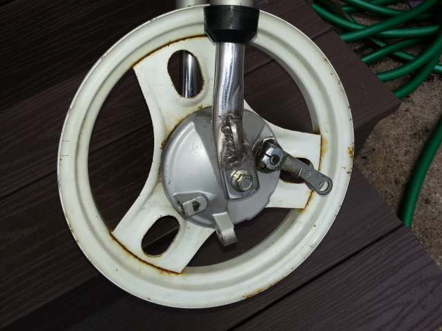

So you've sorted out installation of the 95mm Met hub on the Spree forks? Pics, man, PICS!!
Re: SpreeDio Unofficial 60MPH stock exhaust pipe, stock carb
Hi deuce. It's heat paint. flat black.deuce217 wrote:Cool ride. Is that plasti-dip paint?
Hi wheelman.Wheelman-111 wrote:Greetings:

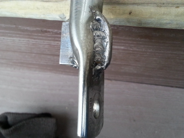

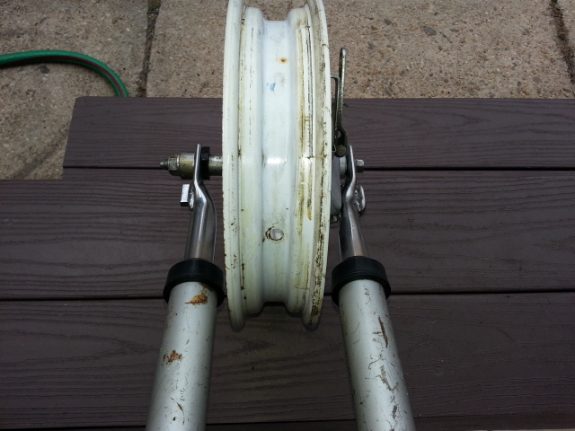

I have something a little better. take a look
The metro wheel and forks. for a swap.
The met hub spree forks works.

I dont think anyone has posted this adaptation before. I believed it could work because the Spree forks telescope like the Met. Not having built a Spree myself, never got to test the theory. Well done. The Dio-powered Spree needs all the stopping power it can get!

^^ that's so true. A lot of people often neglect the stopping part of the upgrade equation...Wheelman-111 wrote:Greetings:
Ped: nice build, thanks for sharing!

Hi forum
Thanks graphite, wheelman, Dio89elite, lovemyhonda, everyone.
The brakes work great. a lot better then the spree brakes.
The tire size is 2.75-10.
Any bigger tire will rub on the spree forks.
I think I'm going to change them to left side. because Honda made the brakes for left side. and my wheel is facing opposite side.
I have to get a longer cable. but everything works fine.
