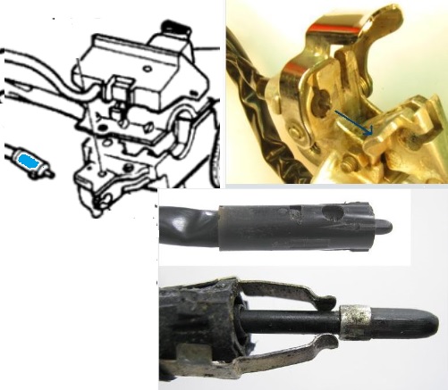

Re: Adjustable Starter limit switch?
Brake switch on the CH80 appears still available for around $12 from Honda
Here's a pic of a dis-assembled switch. It's difficult to get the locking tab released from the switch body (tab fits the rectangular feature in pic below)

Thanks "deuce217" and "mousewheels" for the info and the detailed pics.. I'll take a look.
