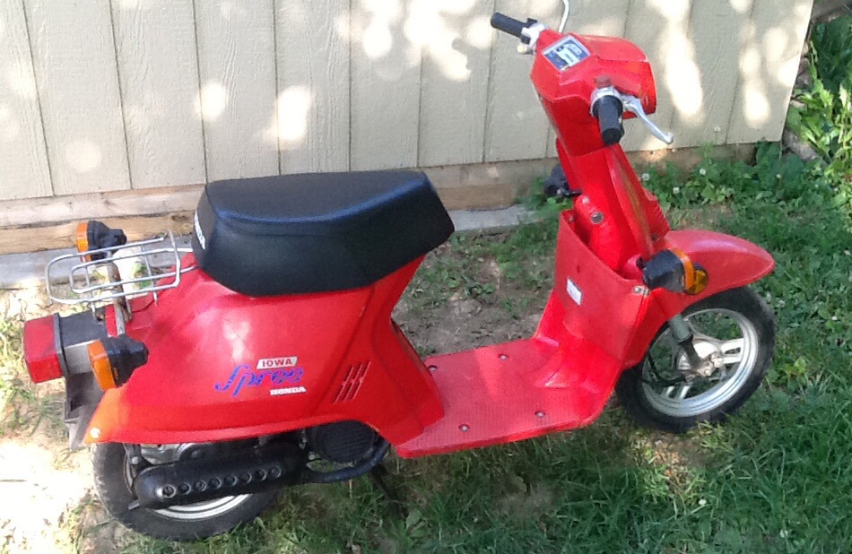

Picked up this 1984 honda spree "Iowa" addition..lol
- image.jpg (227.46 KiB) Viewed 14453 times

Thats some nice spree real clean shape
congrats on the addition
