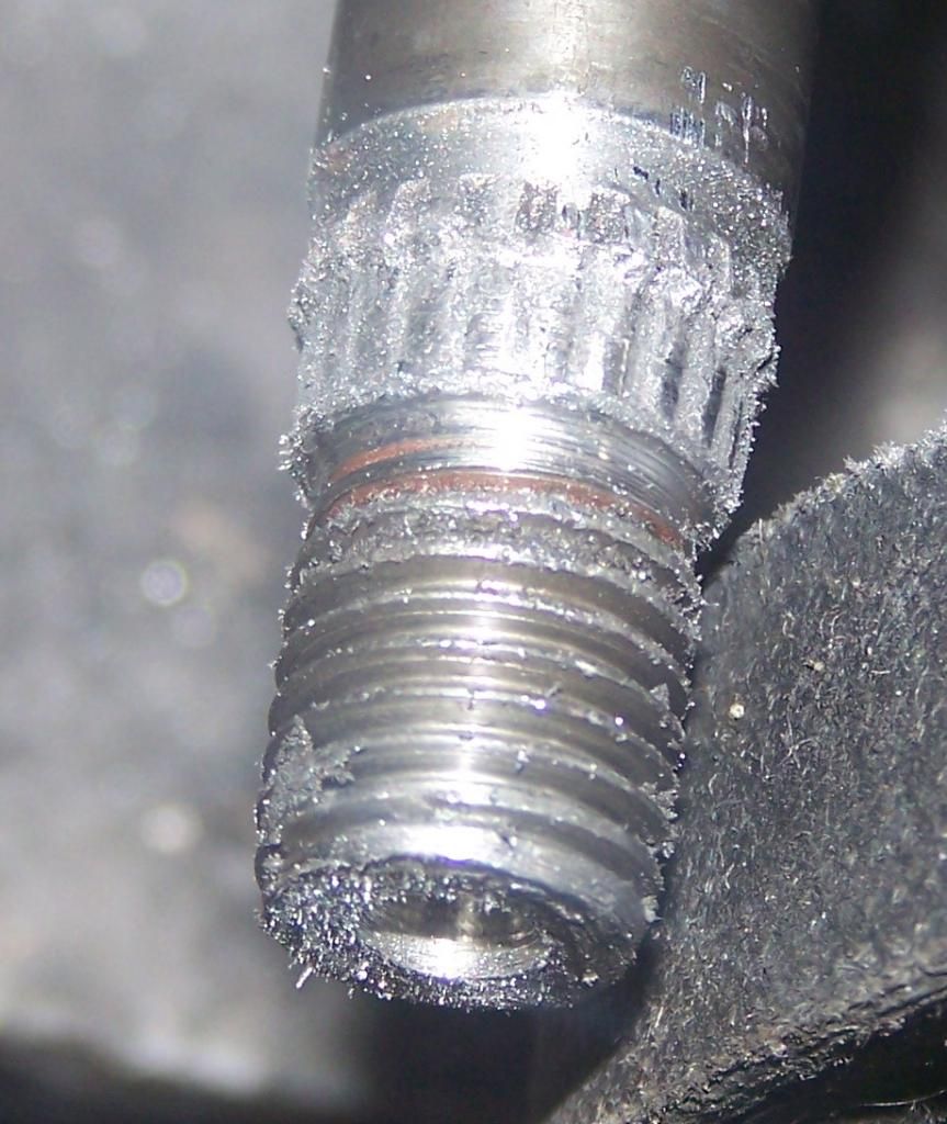

ok i rip it down and this is what i fond
Image\
is that grove normal for a ruckus variator???
ped
Posts: 1598
Location: northeast usa
Re: strip the crank on the Variator side f
Post by ped »
Hi swim. it looks like it's done. :imo: Unless you can make a key way for it?
put new roller in and spot weld it back together for now. :imo:
make sure not to spot weld where the kick starter cogs are.
change the belt by removing the rear clutch. good luck.
Post by paulpauly7 »
that groove is because the ramp is to big for the crank shaft .As your doing it up the ramp plate is riding up on the inner edge of your crank .You need another crank and a malossi variator for the small shaft crank .
