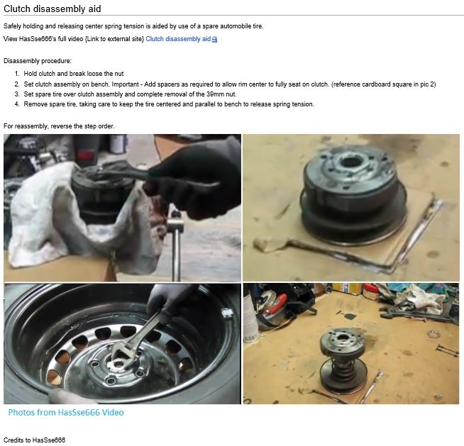

Here's a video with a simple idea of how to easily change the spring out.
https://www.youtube.com/watch?v=i7GQLMi ... e=youtu.be

Found this also for the three small springs. Great stuff!
https://www.youtube.com/watch?v=zsvyOCoWahs

Thanks all :thumbwink: - I searched awhile back for the center spring video to link and capture pics - but came up empty handed. Center spring 'spare tire aid' is now captured to the wiki clutch topic. Will add a section for the clutch shoe spring removal soon.

I just sit on something put my feet on it and undo the nut

I use my feet also. I can't wait to try the snap ring pliers though! Great info
